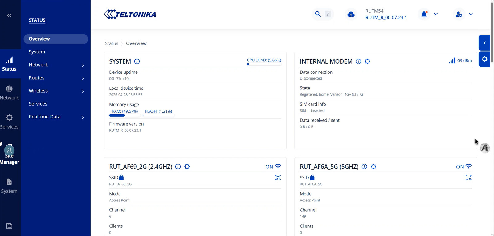

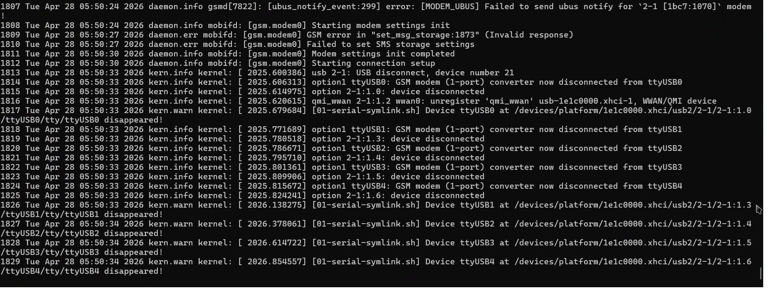

I currently have three RUTM54 modems in the USA equipped with Verizon SIM cards. They connect successfully at first, but the connection drops immediately afterwards, and the log says that the modem was disconnected by the user. Does anyone have a tip on where I should look for the cause of this issue or which settings I should check?
