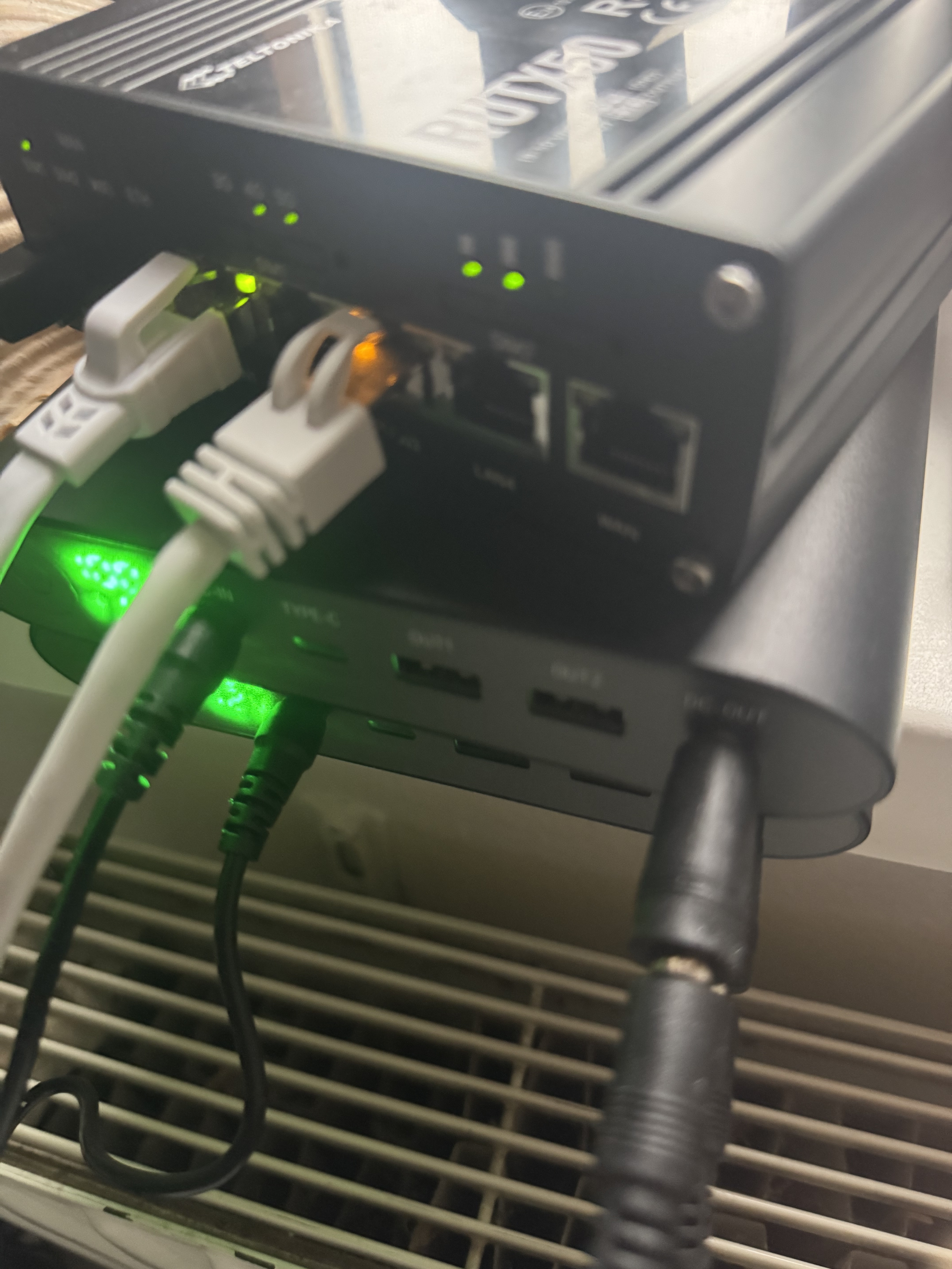

The rutx50 with battery System „litionite Tanker“
For now it runs with 12V on 5V the rutx50 Boot Not real up
need 1x 5521 dc cable , 1x Teltonika PR2PD01B adapter , 1x 5521 adapter
I’ve got on 12V/180Wh = 15Ah to zero

The BAT120 is primarily designed to function as a UPS rather than a portable power bank. As a result, it provides only a limited runtime for connected devices and may not fully meet your needs for extended portable use.
How long can the BAT120 operate independently?
Approximate uptime:
  • RUTX50
    • Idle power ≈ 4.8 W → 17 ÷ 4.8 = 3.54 hours → ≈ 3 hours 32 minutes
    • Maximum power ≈ 18 W → 17 ÷ 18 = 0.94 hours → ≈ 56 minutes 40 seconds
  • RUTM52
    • Idle power ≈ 4.21 W → 17 ÷ 4.21 = 4.04 hours → ≈ 4 hours 2 minutes
    • Maximum power ≈ 13 W → 17 ÷ 13 = 1.31 hours → ≈ 1 hour 18 minutes
Both the RUTX50 and RUTM52 support passive PoE only. Therefore, this switch on its own will not be suitable for powering them. You may want to consider either a passive PoE switch or an active-to-passive PoE adapter. Unfortunately, we do not offer these types of converters, so you may need to look for a third-party alternative.
