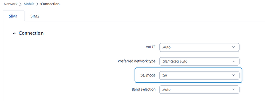

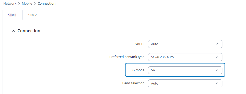

If SA is indeed supported, could you also check whether it is explicitly selected under Network → Mobile → Connection settings tab?

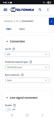

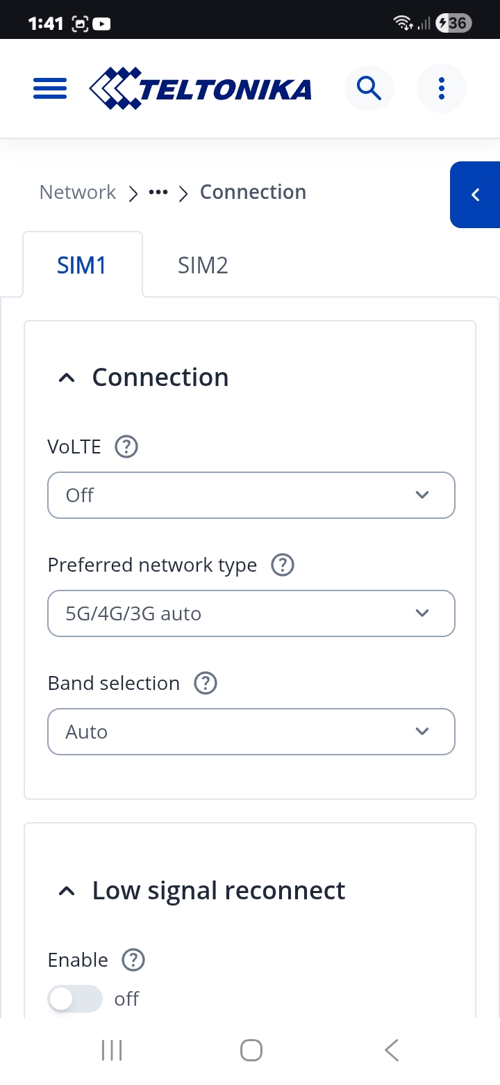

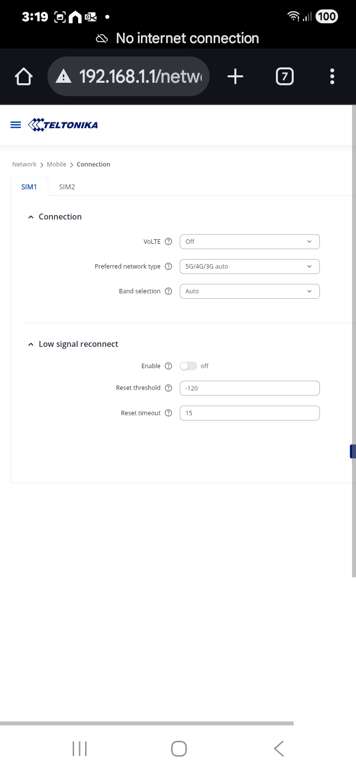

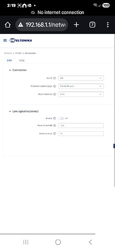

Regards the 5g Sa switch on the diagram you posted my gui does not have that as an option.

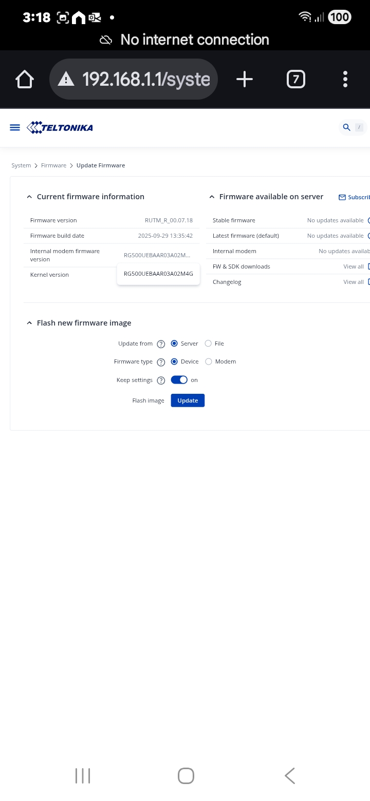

Could you please confirm which firmware version is currently running on this device? Make sure it’s updated to the latest stable or newest available release.
It also seems you’re accessing the WebUI from a mobile device, could you try switching to desktop site mode or connecting to the WebUI from a computer or another non-mobile device to verify if the 5G SA option appears there?
Additionally, could you share the internal modem firmware version (found under the System → Firmware page) currently installed on your device?
Thanks for the reply.
I have tried latest and latest stable firmware.
I understand the s24 has far more advanced modem I was using the reference to indeed check for a usable telstra n5 band.
At the time I tested the Rutm51 on band n5 I had a very good -73 rssi and it was the only band that was available at the time. The Rutm51 could see the band no issue it just would not connect. It displayed a message similar to. CAMPED ON BAND EMERGENCY CALLS ONLY. It would not connect.
