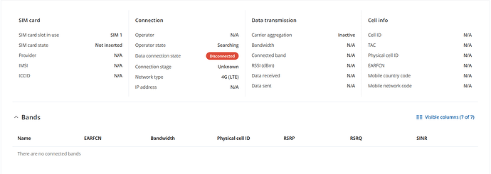

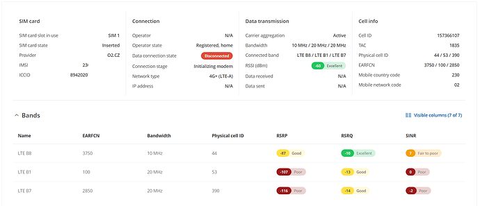

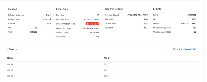

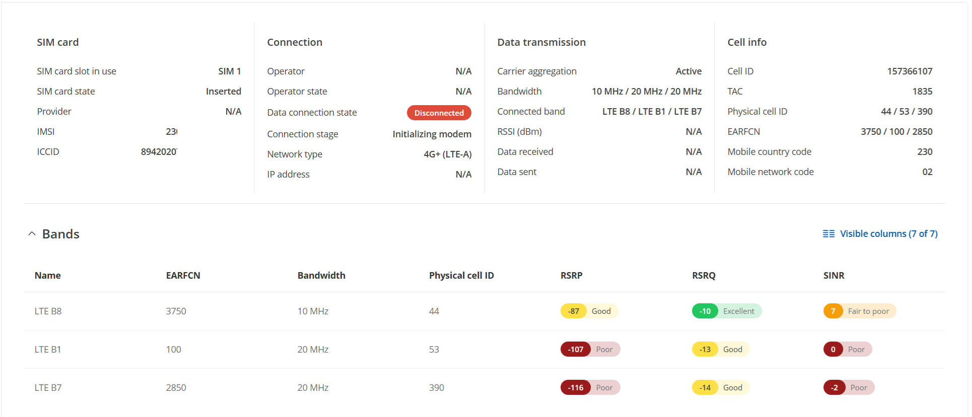

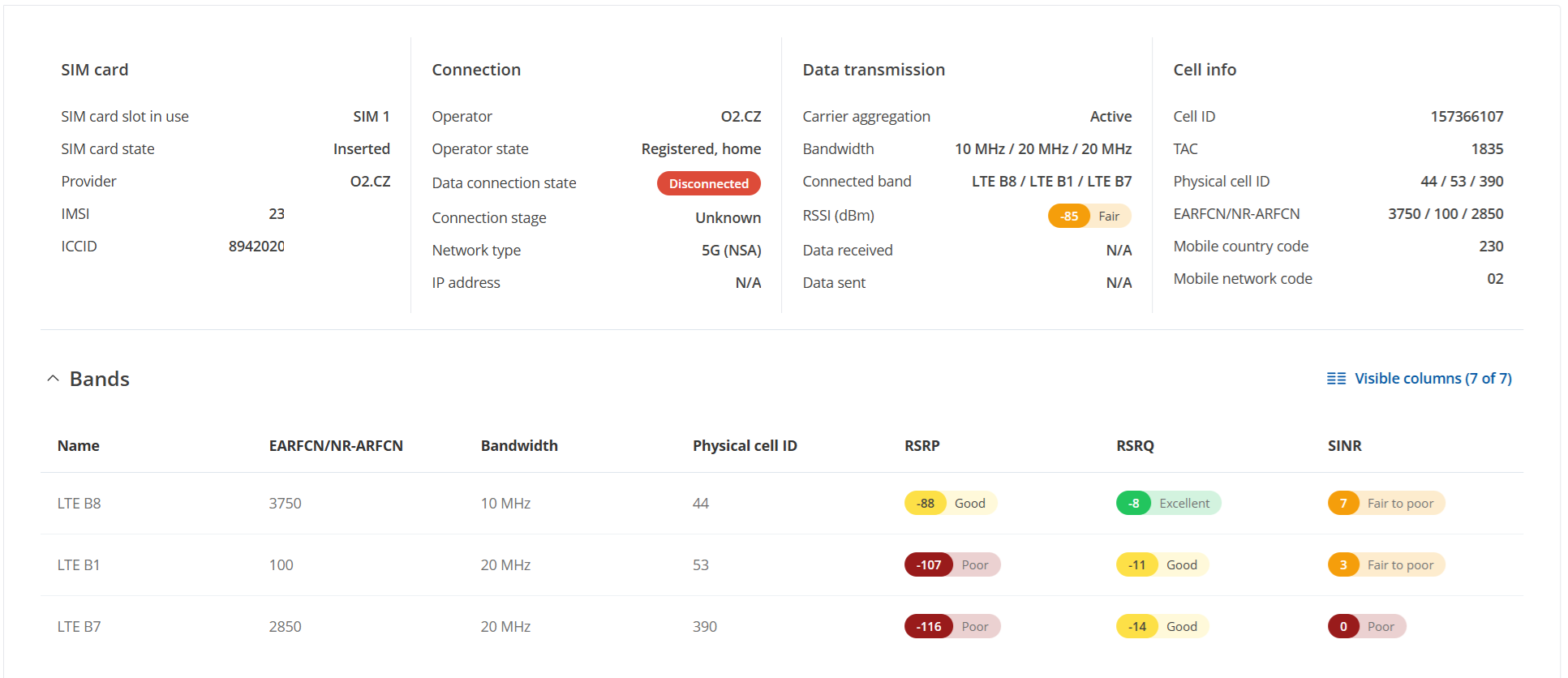

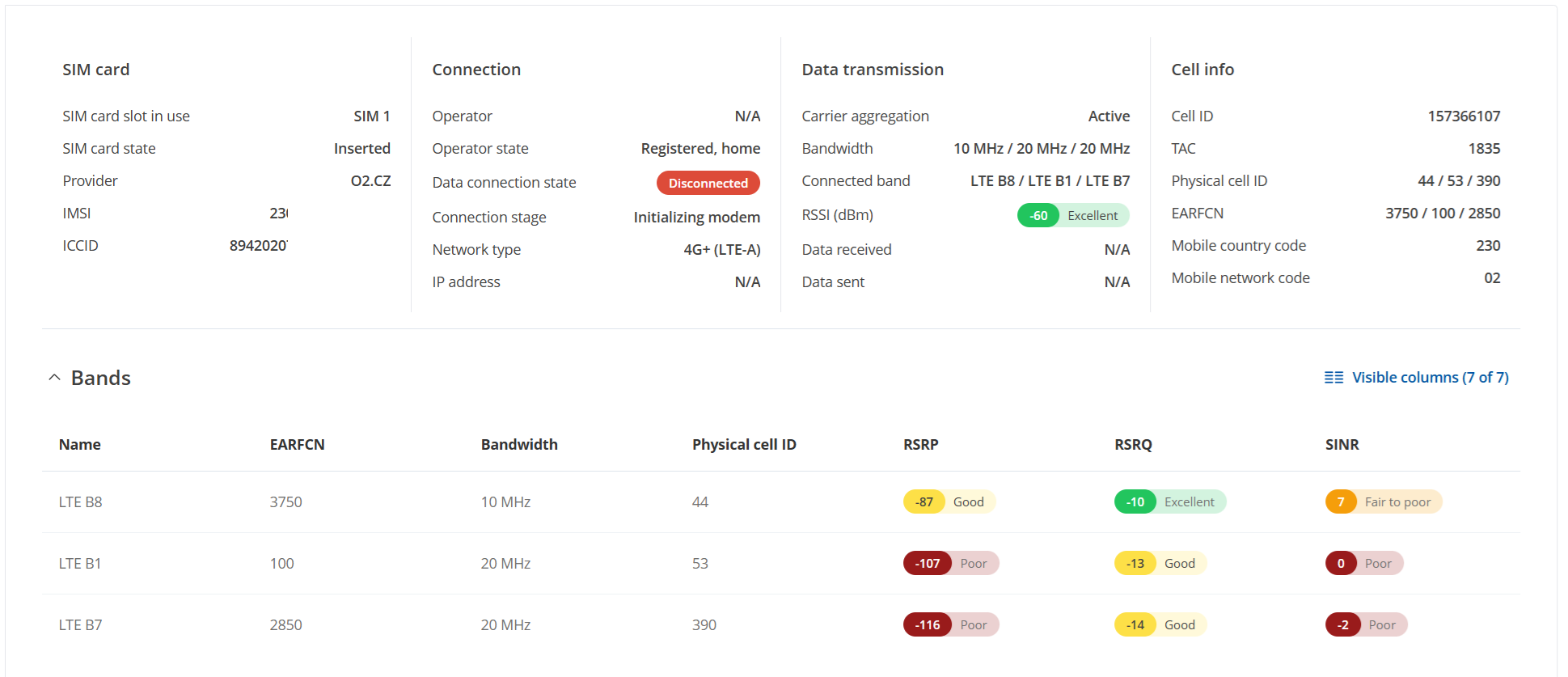

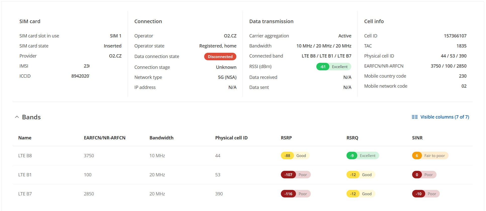

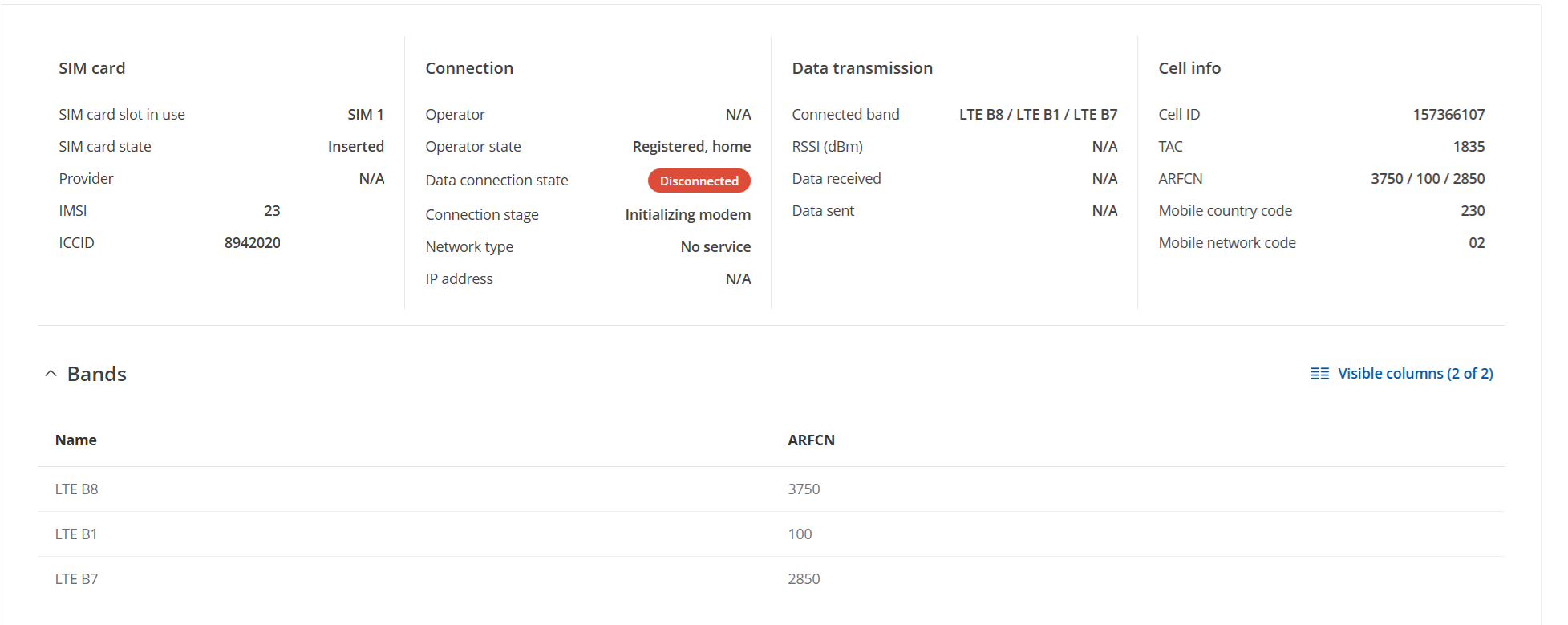

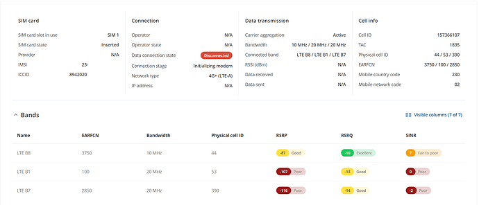

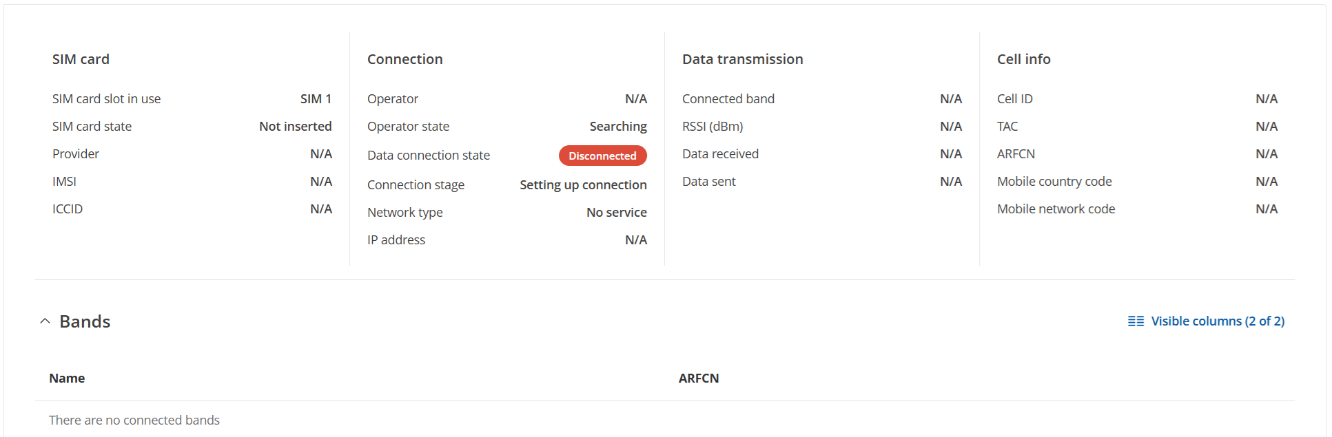

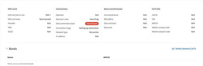

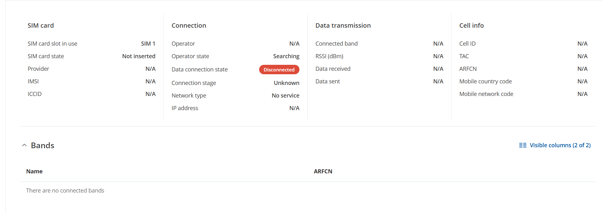

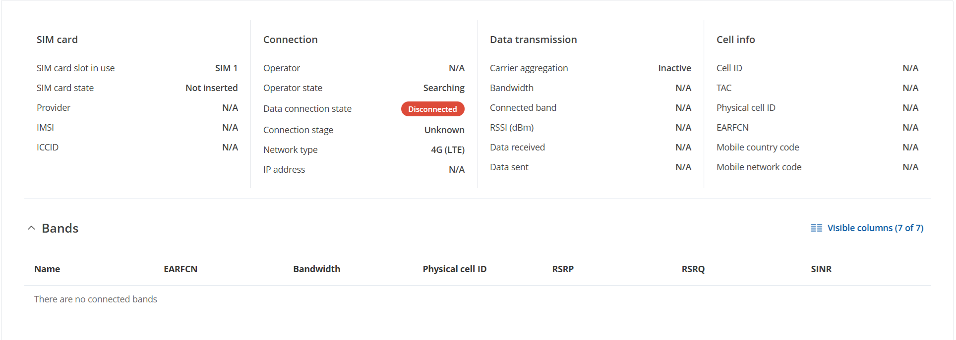

Screenshots:
Thank you for your update.
To investigate your issue more effectively, I have sent a form to your email address (the one used for forum registration). Please complete the form using 12788 as the ticket ID. Once submitted, we will contact you privately to assist you further.
