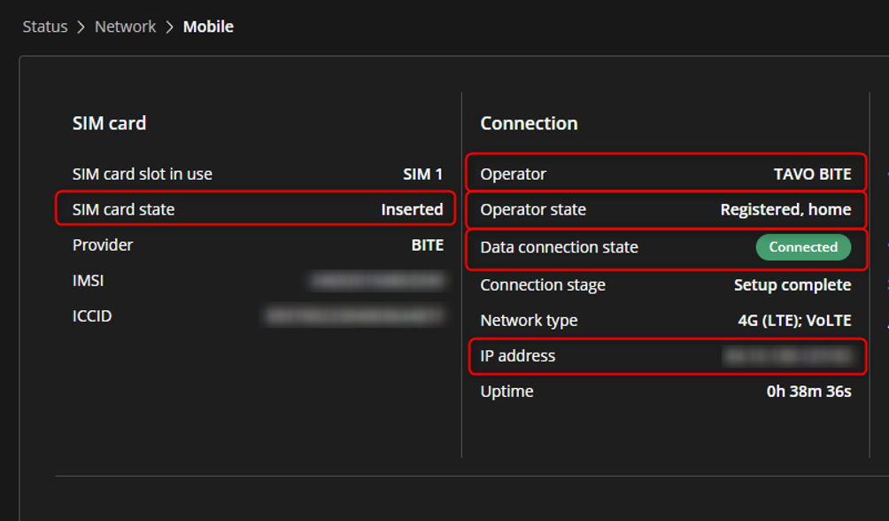

Since the RUTM50 and Poynting antenna were working previously, to troubleshoot the issue further, please provide the following information, which you can find by navigating to Status > Network > Mobile on the WebUI of the device.
Please check the following fields:
  1. Is the SIM shown as Inserted?
  2. Is a mobile operator shown?
  3. Is the router registered to the network?
  4. Does the connection state show Connected?
  5. Is a mobile IP address assigned?
Please also confirm whether the BH Mobile SIM works normally when inserted into a phone at the same location.
For reference, see the screenshot below showing where these values can be found:
This information will help us determine whether the issue is related to SIM detection, network registration, or the data connection.
