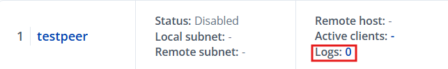

  • The IPsec logs that can be found as shown in the picture
