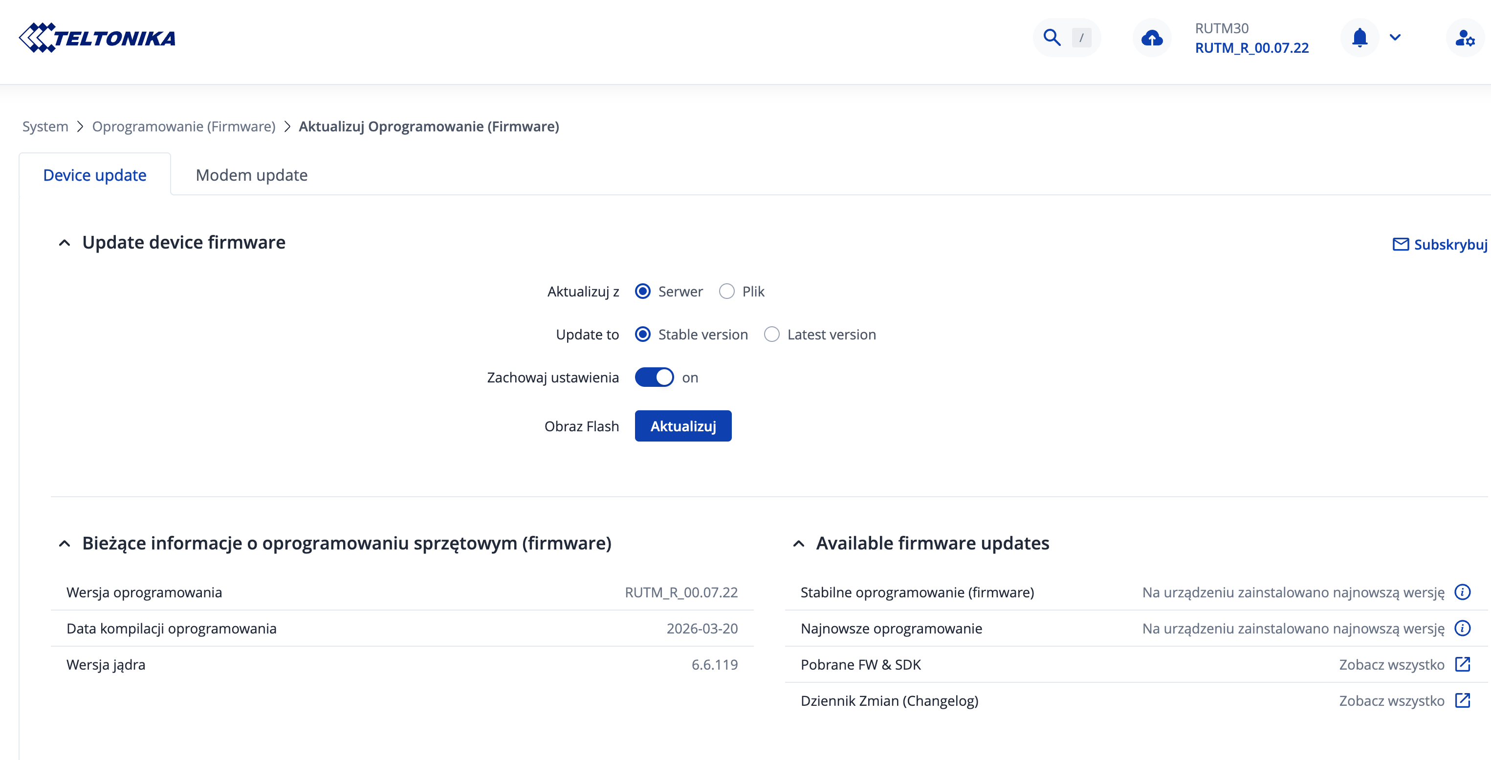

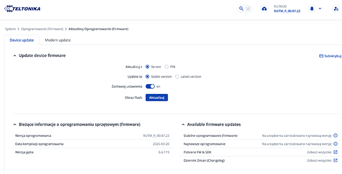

Today I updated the software to version RUTM_R_00.07.22 (previously .21.3) and I have the exact same problem as described: RUTX50 Internal Modem Update Failed - #14

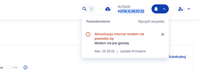

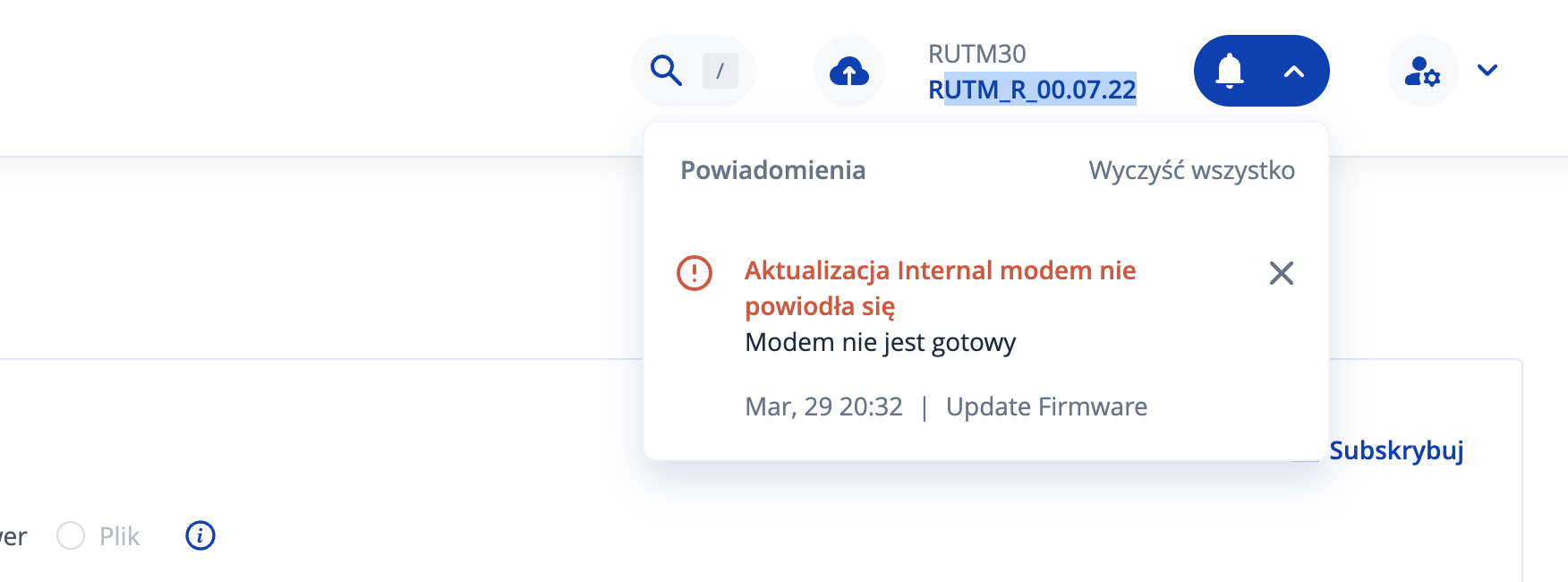

I can supposedly update the modem, but it won’t work. I’m using e-SIM. Interestingly enough… the installation of additional packages in this ZeroTier also stopped because it was waiting for a network connection, but I do have a network connection because I connected via RMS… and I managed to upload the ZeroTier package for my software version normally, using the upload method, and this service is working properly… what’s this new problem? The text on the image says: “Internal modem update failed.”
The modem is not ready.
