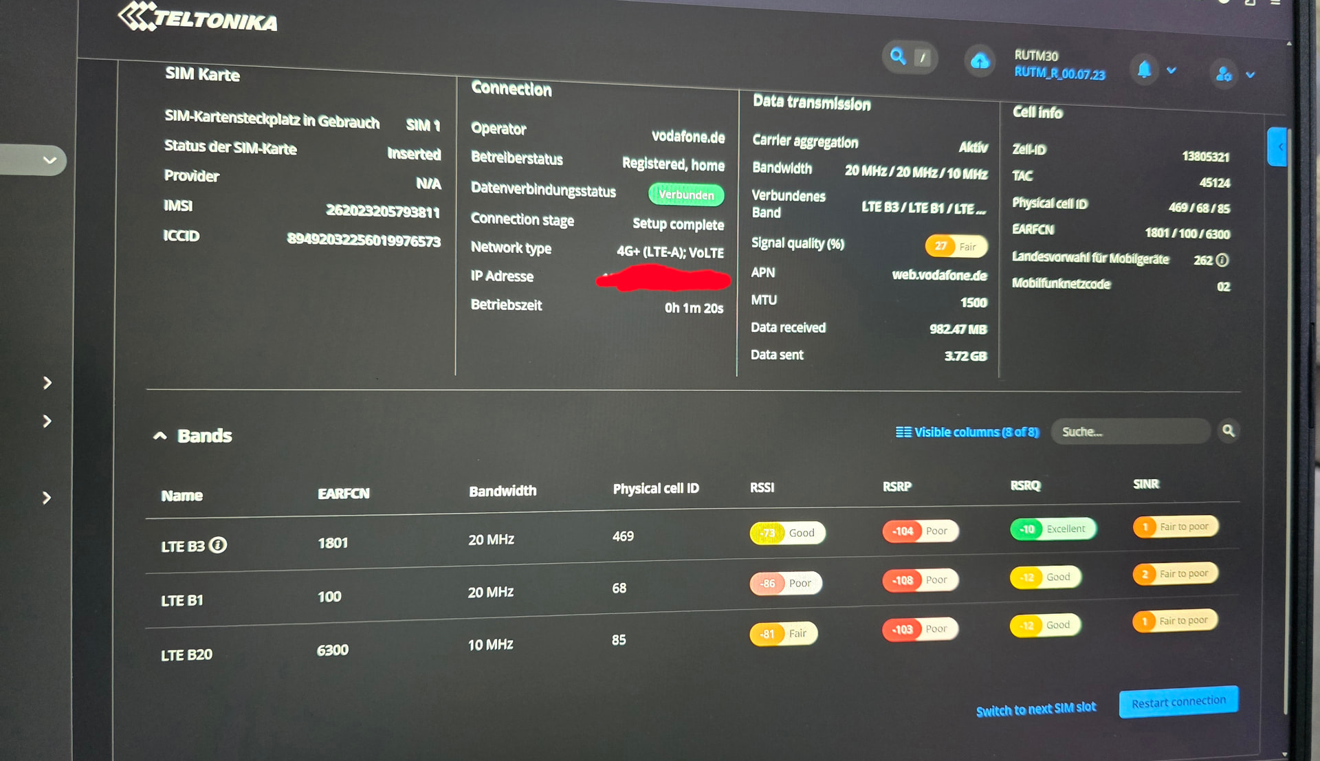

This is typically caused by poor signal strengths, is the RUT in a building?
Are you using the supplied antennas or one of your own?
Can you provide a screenshot of this page: Status > Network > Mobile masking out your IMSI number.

The RUTM30 suffers from the same modem firmware bug as the RUTX50. Zet the connection to 4G/3G only and the connection will be stable, and wait for a update

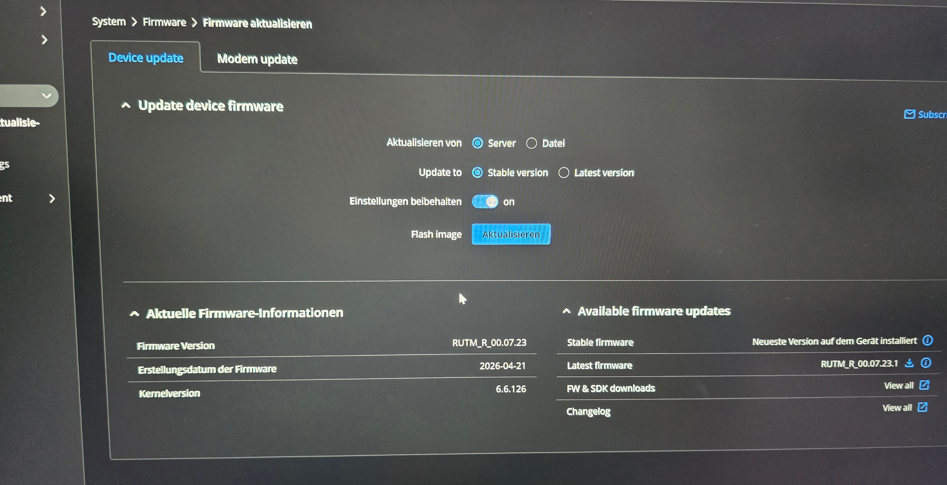

So, today I configured it at home and attached a screenshot. Unfortunately, the signal inside the apartment isn’t very good, but I hope the picture can still show a little bit and maybe help.
