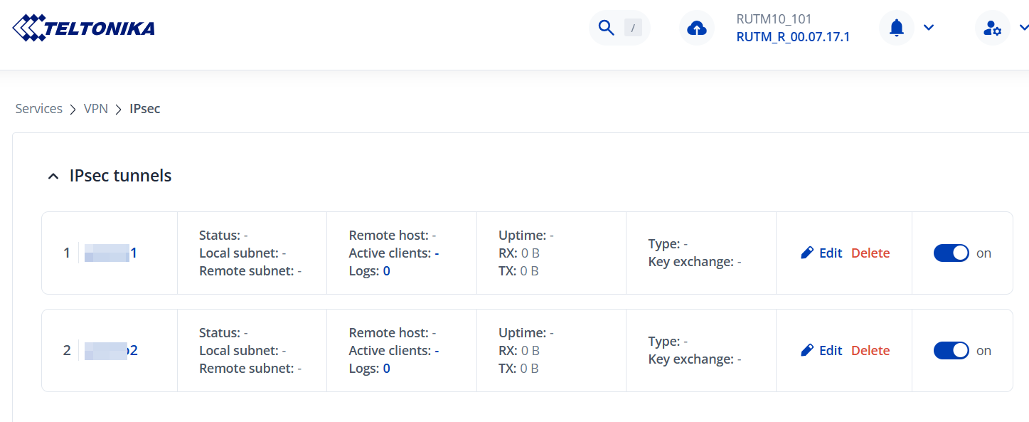

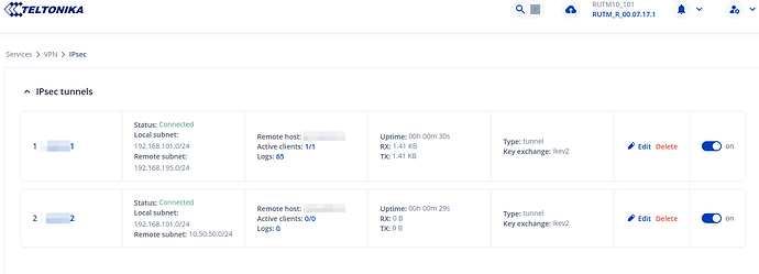

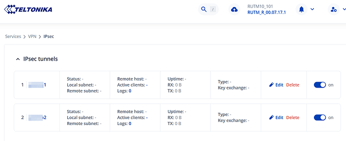

We have configured IPsec for LAN-to-LAN connection. Everything is working OK, but after some time (~ 1hour) there is wrong status displayed despite VPN connection is up & running
Status at start
Status after 1 hour - connection is up&running

Good atfernoon,
From your description, if i understand correctly the issue is with the WEBUI presenting the status and other information, rather than the device experiencing connection problems? Your VPN tunnel is operational, and you are able to reach end devices, right?
If that is the case, I wanted you to try opening the WEBUI in incognito window, or another browser.
Arturas
Hello
I already did as you suggested. I was thinking about some cache issues in web browser. If I reboot router the connection status is OK again - for about one hour.
Robert
Hello there,
Apologies for the late reply, but could you confirm that the issue is still present? If so, could you please also confirm that you are running on the latest available firmware for the RUTM10, which is 7.17.4? The firmware download page can be found here: RUTM10 Firmware Downloads - Teltonika Networks Wiki
