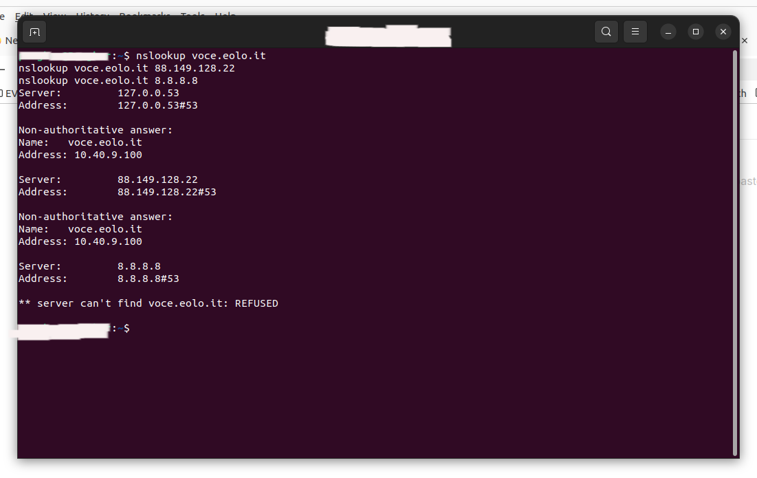

I’ve tested DNS resolution from a client connected behind the RUTM08 (LAN 192.168.1.x).
Google DNS (8.8.8.8) and Cloudflare (1.1.1.1) return NXDOMAIN for voce.eolo.it.
EOLO DNS (88.149.128.12 and 88.149.128.22) correctly resolve voce.eolo.it to 10.40.9.100.
Please find attached the screenshots of the tests.

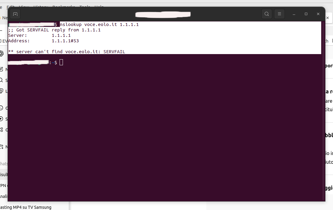

Attached the screenshot for nslookup voce.eolo.it 1.1.1.1 too
