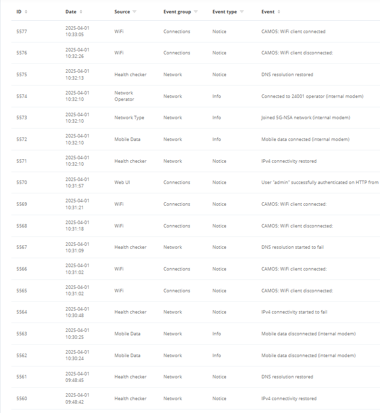

Today the router is acting up even worse than before, it has disconnected the internal modem twice before lunch today.
just a snippet from the network event log.

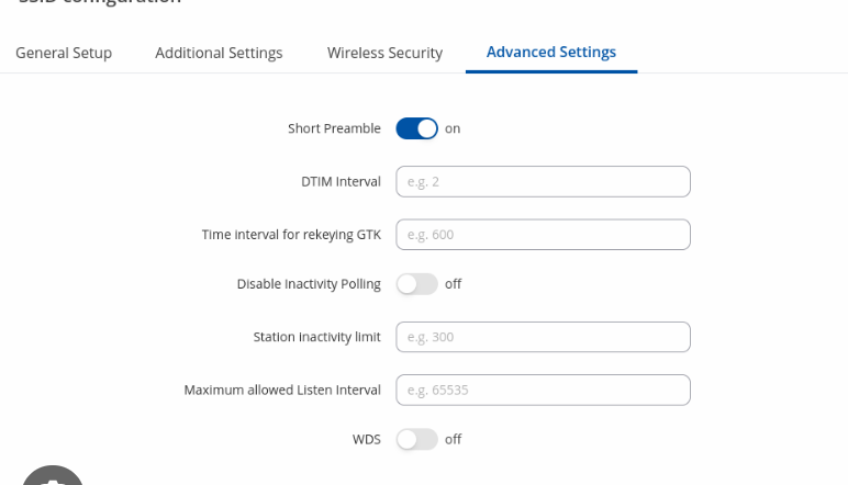

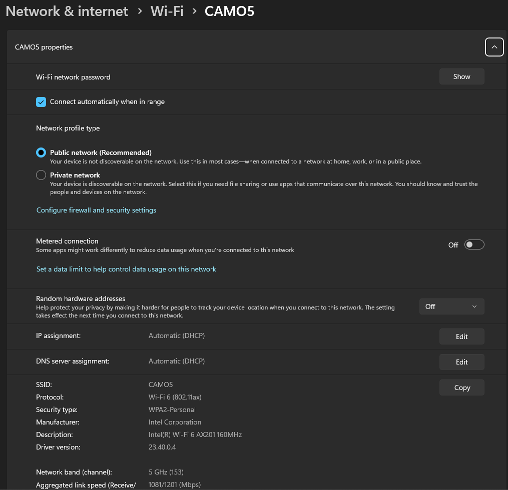

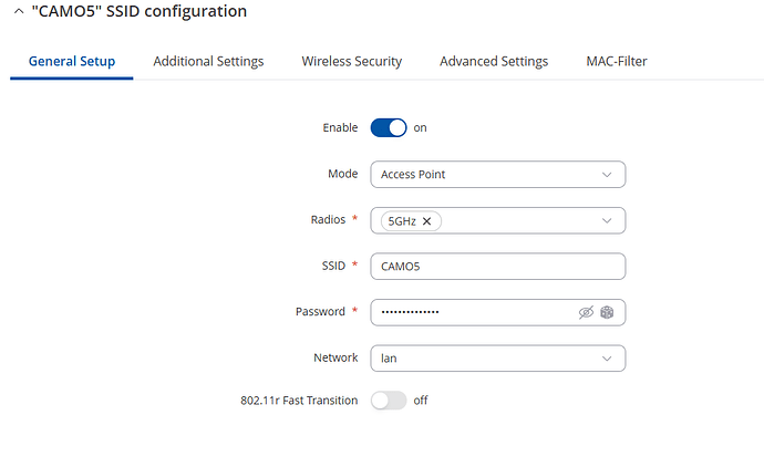

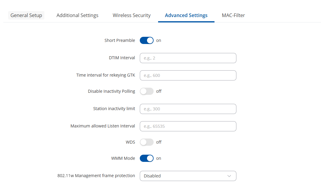

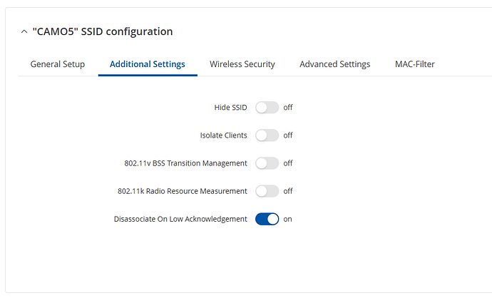

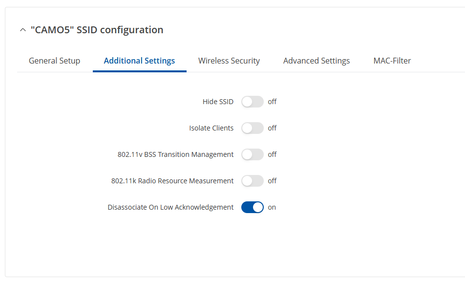

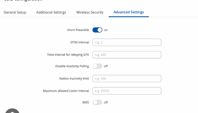

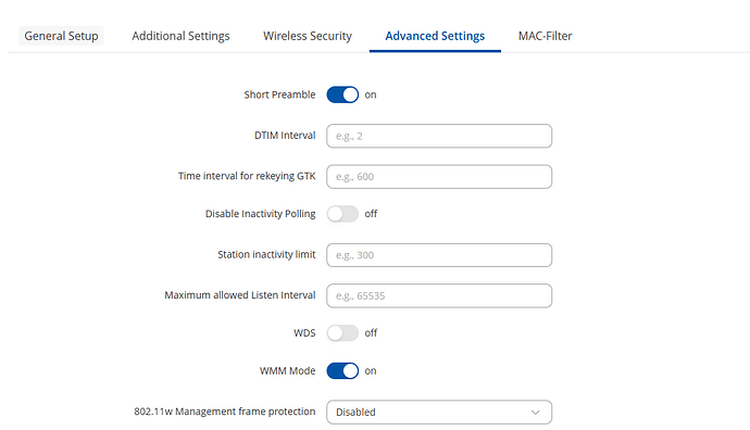

Can you share a screen of the WiFi setting of your device?
that i can do…
Hi… Sorry…
I was talking the screen settings of the Teltonika device.
Sample…
General Setup? Additional Settings? Advanced Settings?
Thank you.

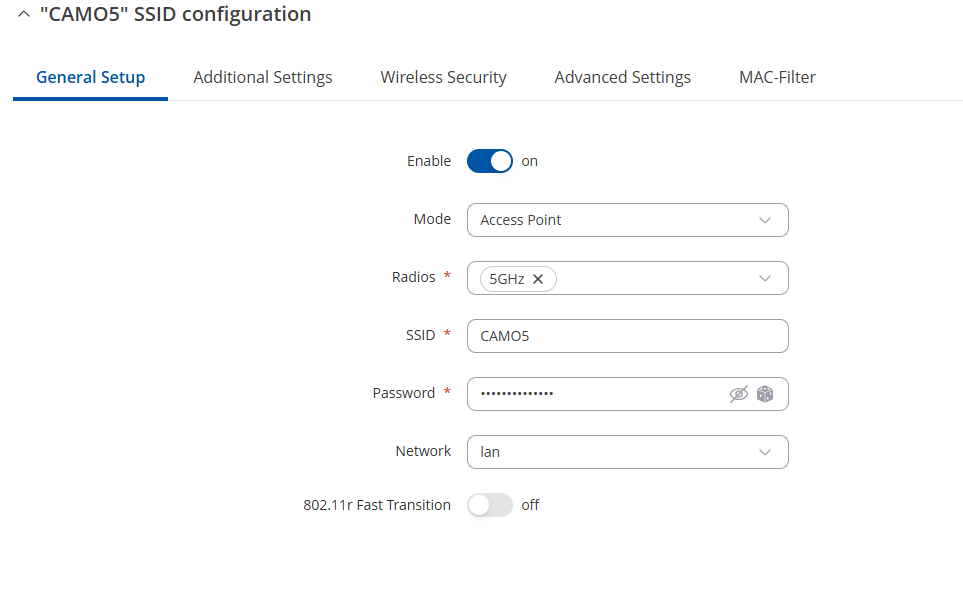

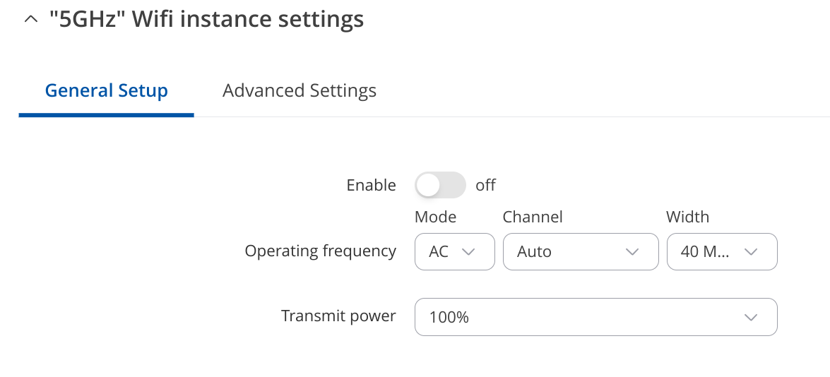

Hi…
Just for test…
Can you change channel size from 80MHz to 40MHz?
Sample…
tried these settings on the 5GHz wifi.
After applying the changes the WIFI gets dropped on my computer and i can’t find it when looking for available WIFI networks.
switching over to the 2.4Ghz to get into the router again, and i can see the 5GHz wifi is still up and running but as i said i can’t find/access it from my computer, Swapping the width back to 80Mhz makes it show up again in my computer and im also able to connect via the 5Ghz wifi again.
Have you try to change the channel of your 5GHz wifi?
It is in auto? Can you change it, just for a test, to a static channel?
