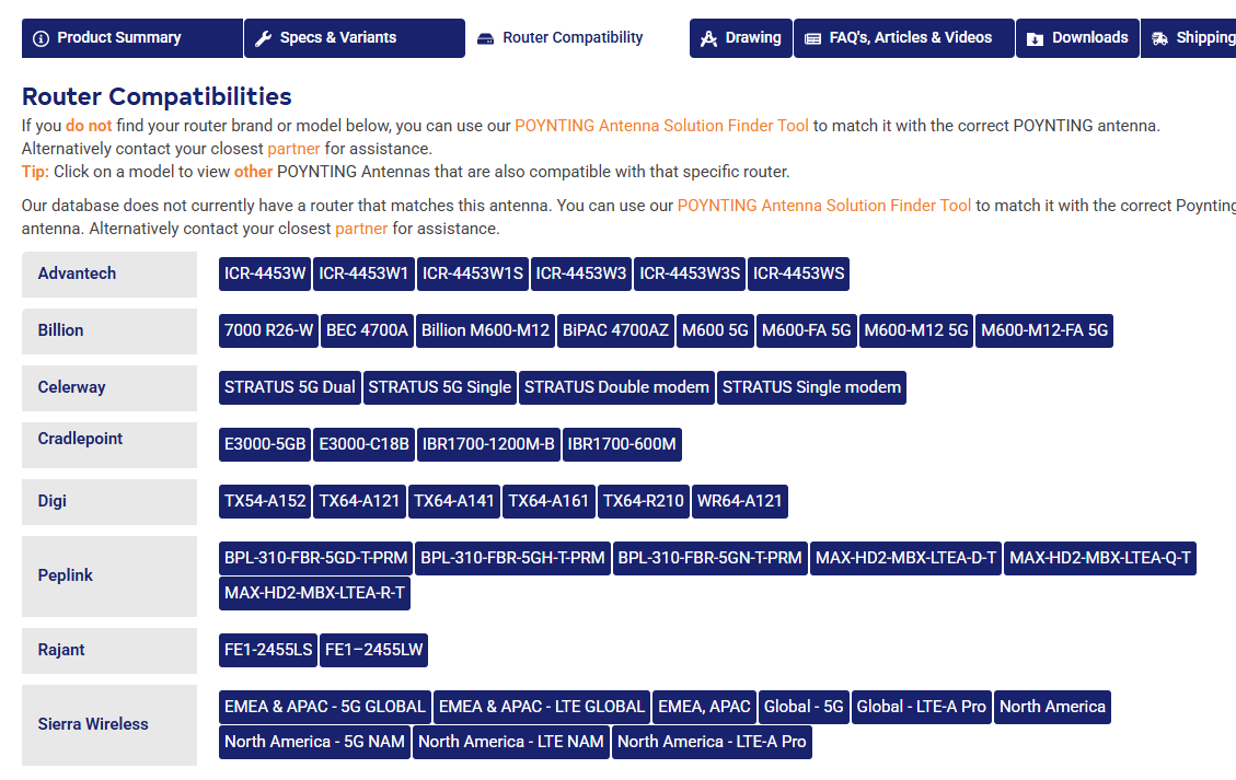

Ok. So I have found a 9/1 antenna. Poynting. Which has 4 WiFi aerials. Would this work please.
Since it is a Poynting antenna, you would have to reach out to their support to ask whether it’s compatible or not. I wasn’t able to find any information regarding compatibility with the RUTC50. In the webpage of the antenna, I don’t see Teltonika listed as a compatible partner as seen below:
Fair enough. It looks like teltonika do not do an external antenna for the rutc50 yet that is suitable. Bit of a pity. Thanks anyway.
