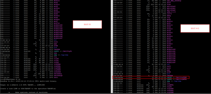

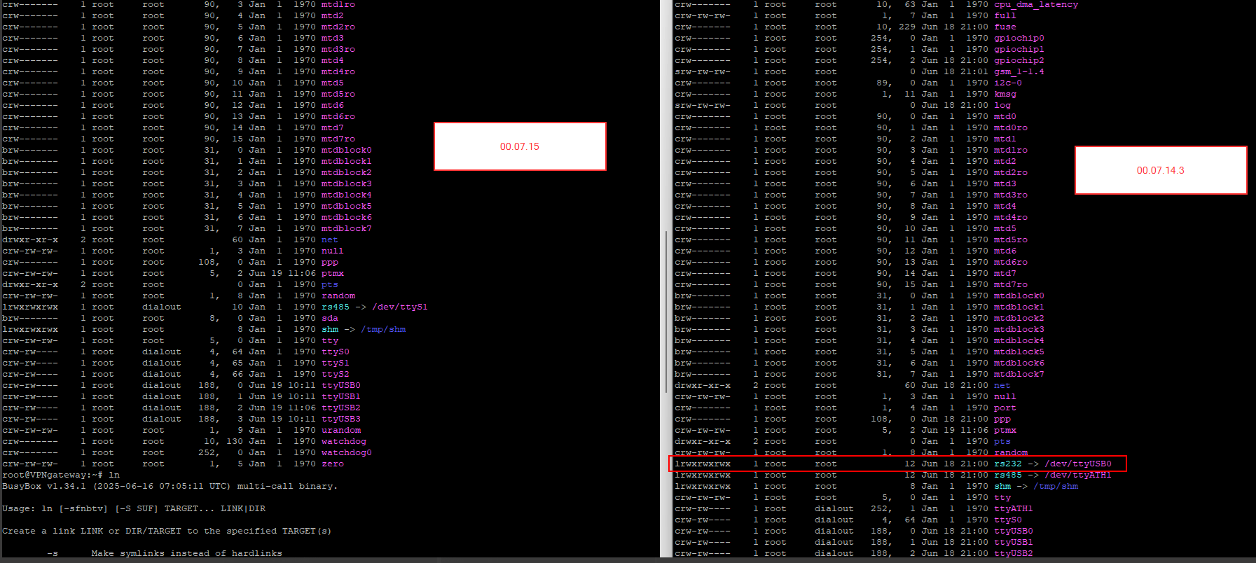

Actually we located the Problem.
Usually the Kerne mapps the RS232 interface to /dev/ttyUSB0
In RUT9M_R_00.07.15 the RS232 Interface is not mapped.
See Image.
