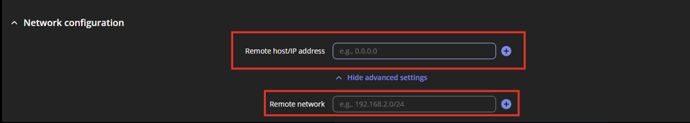

To help us understand the current situation, please enter the OpenVPN server’s public IP address in the Remote host/IP address field. In the Remote network field, enter the LAN subnet behind the OpenVPN server, including its subnet prefix.
After saving and applying the settings, please check that the OpenVPN client instance is connected to the server. If it is not connected, please verify the configuration and review the instance’s Logs for further details about the connection issue.
