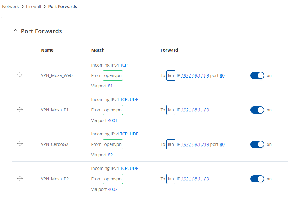

I have configured OpenVPN (Client) on my RUT956. It successfully connects to my Office Network and gets assigned an IP of 192.168.254.2 inside the office network. From my laptop, connected the office network, I can access the web interface on the Router at 192.168.254.2. HTTPS also works and I can also succcessfully access the Serial to IP on TCP 5000.
However, I have a couple devices on the LAN side of the router that I need to access. I have a Victron Cerbo GX (192.168.1.219, Web Interface) and Moxa Nport (192.168.1.189, Web Interface and TCP-Serial Server Ports). I can not get any of the port forwards to work.
I have followed as many other similar problems but none of the setting changes work.
My port forwards are as follows:

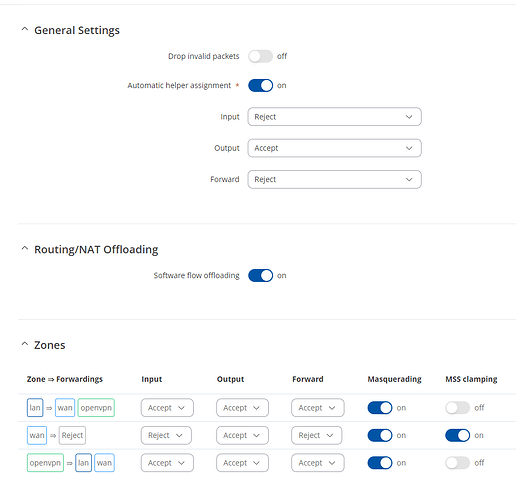

Here are the General Settings Config:
Any help would be appreciated.
