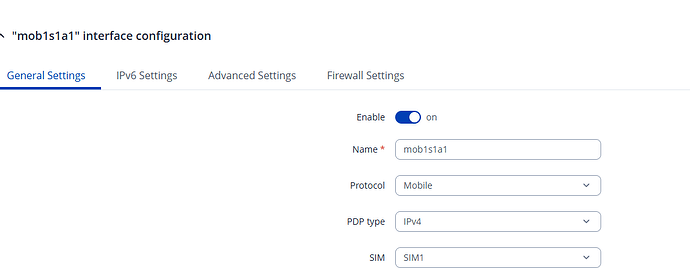

  1. Navigate to Network → WAN and click Edit on the mobile interface (mob1s1a1 if the SIM card is in slot 1).
  2. Change the PDP type to IPv4.

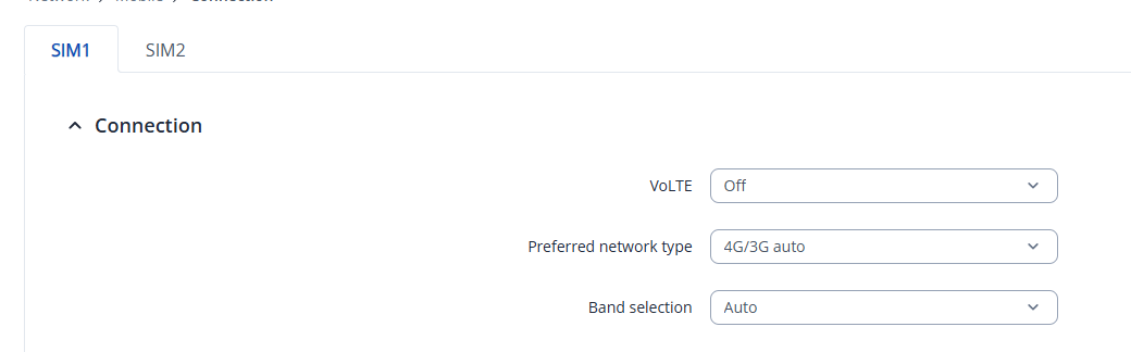

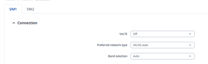

  1. Go to Network → Mobile → Connection.
  2. Try disabling VoLTE.
Please let me know the results.
None of the proposed changes solve the problem.
