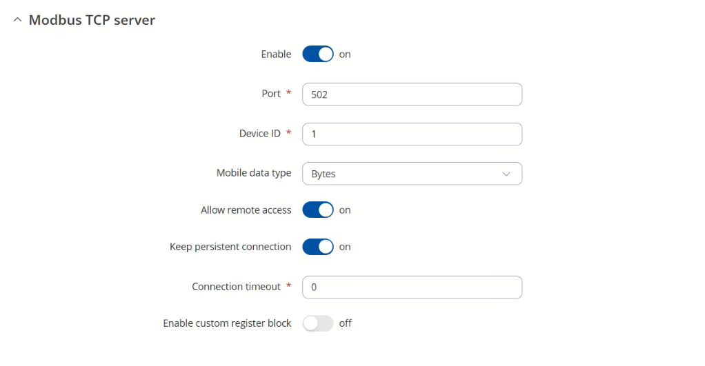

  1. Enable Modbus TCP Server:

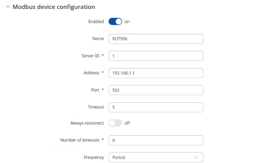

  1. Configure Modbus TCP Client:
  • Go to Services > Modbus > Modbus TCP Client and click Add.
  • Set up the RUT device as a TCP Modbus client:

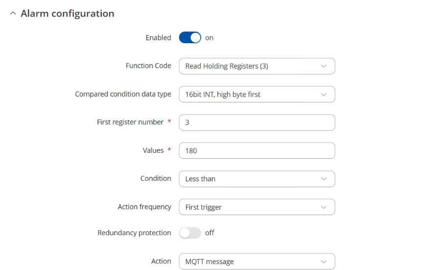

  1. Configure Modbus Alarm:
  • Scroll down to the Alarms section and click Add.
  • Enable the alarm and configure the following parameters:
    • Function code: Read Holding Registers
    • First register number: 3 (this register stores the uptime in seconds)
    • Condition: Less than
    • Value: 180 (uptime in seconds)
    • Action frequency: First trigger

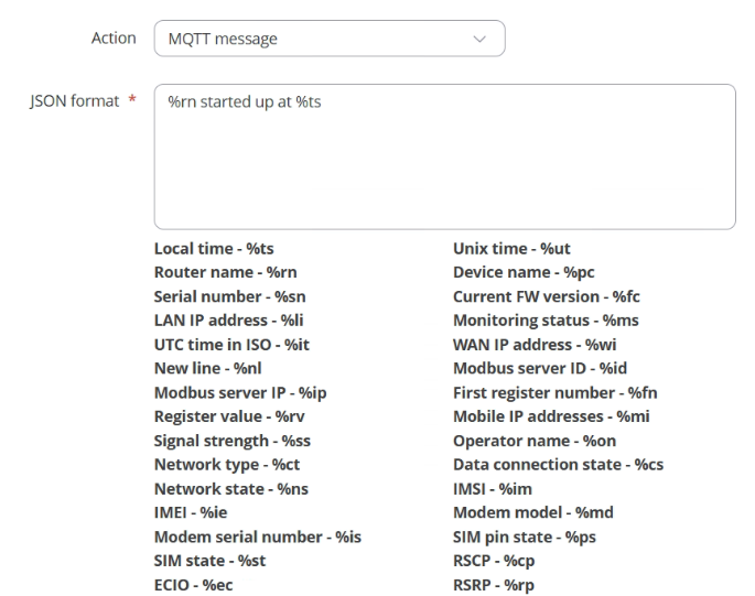

    • Action: MQTT message
  • In the JSON format, define your MQTT message, for example:
    • "%rn started up at %ts"
    • This will translate to: {Router name} started up at {Local time}.

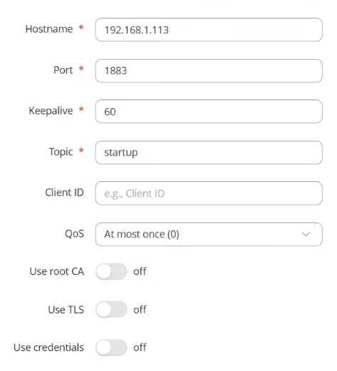

  1. Set MQTT Message Parameters:
  • Hostname: Specify the receiver of the MQTT message (e.g., a Windows PC with IP 192.168.1.113).
  • Keepalive: 60
  • Topic: “startup”

For testing, I used a Windows PC as the MQTT subscriber with the following command:
mosquitto_sub -h 192.168.1.113 -p 1883 -t startup
After restarting the device, I successfully received the MQTT message.
