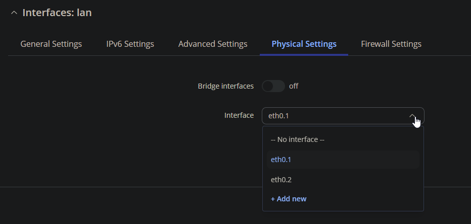

Under Network/LAN on my RUT956, I clicked Edit on lan or lan1 and clicked on Physical Settings. My intent was to have separate lan networks on each physical ethernet port.
But the drop down only shows eth0.1 and eth0.2. as per the screenshot below. While playing around with settings, I got a message that eth0.2 was used by the WAN port.
The RUT956 has four rj45 ethernet ports. I would expect to see eth0.1 through eth0.4 in the dropdown, with eth0.4 being the WAN port (or vice versa).

By default RUT956 has two VLANs - one for LAN and second for WAN. You will need to seperate LAN ports into multiple VLANs, go to Network → Vlan → Port Based and create untagged VLAN for each port (and remove it from the main VLAN), then you will have physical eth0.x interfaces for each port.
See https://wiki.teltonika-networks.com/view/VLAN_Set_Up page for instructions.
Ah. So eth0.1 is a label for vlan 1 and eth0.2 is a label for vlan 2.
How do I include the wifi in the lan?
Yes. Create LAN interface and then go to Wireless SSID settings, edit it and select Network that LAN interface that you created.
