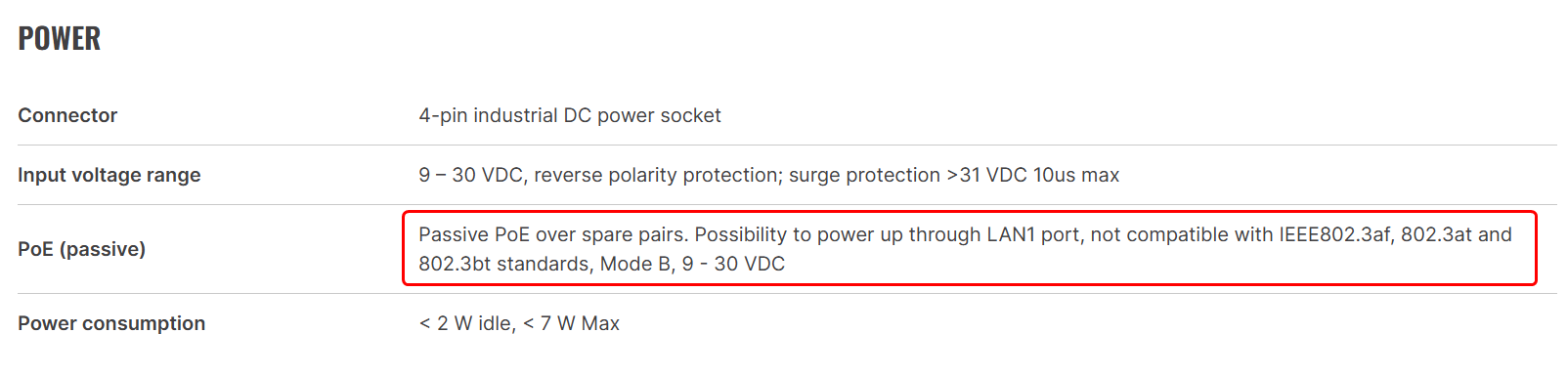

If you go to the device page of the RUT956, found here: RUT956 RS232 / RS485 Cellular Router
You will find that the device has Passive PoE with certain standards that are not compatible:
Unless your question was simply “What Teltonika devices are compatible with what Teltonika devices” - then the answer would be that all devices are compatible with all devices.
