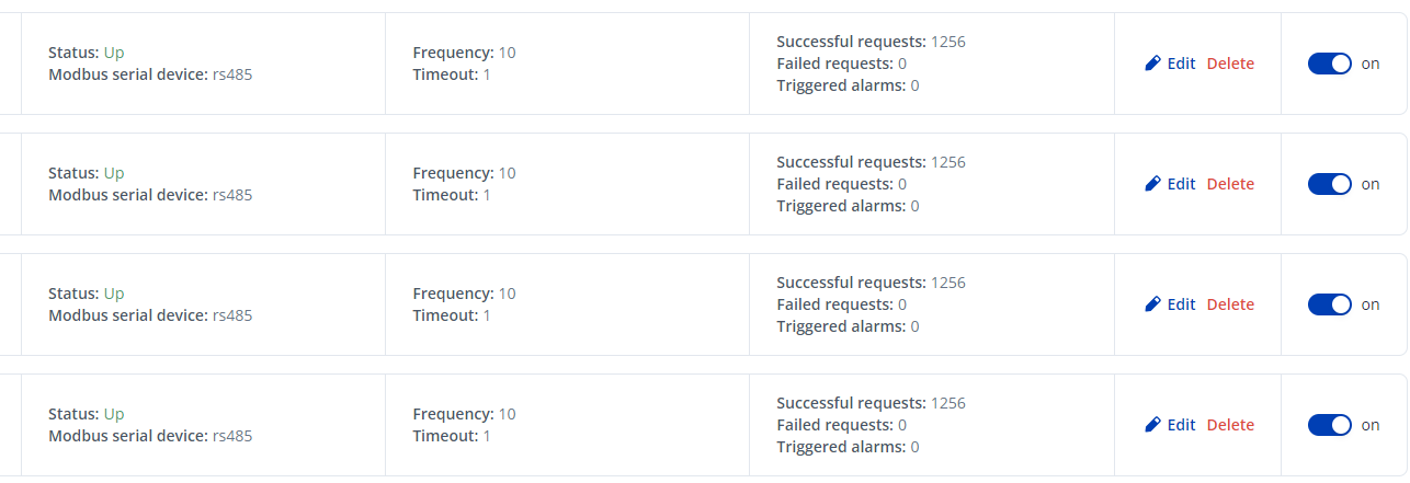

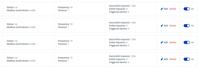

I’m reading several MODBUS variables from 4 devices every 10 seconds with no errors.

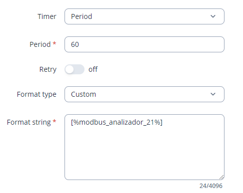

I’m sending these variables to a MQTT server every 60 seconds but, for unknown reasons, some routers (same model) avoid some fields just sometimes:

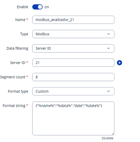

3. Complete Modbus configuration
Could you provide the complete Modbus configuration, including:
  • All configured Modbus requests and their names.
  • Server IDs (Slave IDs) of the four Modbus devices.
  • Register addresses and data types.
  • Polling frequencies.
Why we need this: We would like to verify that all intended variables are being requested correctly and that the current Server ID 21 filter includes the required Modbus data.

1. Modbus device availability
You mentioned that the issue occurs when one of the Modbus devices is switched off.
Yes, it is one of the cases.
Could you clarify whether the missing fields correspond specifically to the device that becomes unavailable? Also, do all fields reappear automatically once that device is switched back on?
The missing fileds can belong to another device. All fields reappear automatically once that device is switched back on.
When one device is off, it affects the remaining devices.
Work in progres.

One last question:
It is not explained anywhere how MODBUS values are processed as MQTT values on Data to Server. I suspect this is where the problem is.
