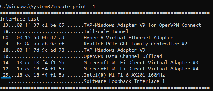

To clarify, this is actually a typical behavior on most systems. When you connect your laptop via Ethernet, the operating system prioritizes the wired connection over Wi-Fi because it typically assigns it a lower routing metric (higher priority). You can confirm this by running the following command in Command Prompt:
route print -4
This will show the routing table, including interface priorities.

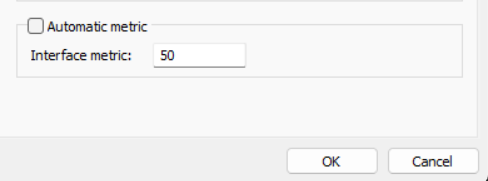

Option 1: Manually adjust routing metrics
You can assign a higher (lower priority) metric to the Ethernet interface so your Wi-Fi remains preferred for internet traffic.
Steps (Windows):
  1. Go to Control Panel → Network and Internet → Network Connections
  2. Right-click on your Ethernet adapterProperties
  3. Select Internet Protocol Version 4 (TCP/IPv4)Properties
  4. Click Advanced…
  5. Uncheck Automatic metric
  6. Set a higher number (e.g. 50) than your Wi-Fi interface metric (which you can check with route print -4):
  7. Click OK to save settings.
Option 2: Use a static route (command line)
Alternatively, you can manually add a static default route via your Wi-Fi interface with a lower metric:
route add 0.0.0.0 mask 0.0.0.0 <WiFi_Gateway_IP> metric 10 if <WiFi_Interface_Number>
You can find the <WiFi_Interface_Number> in the Interface List section of the route print output:
This way, your laptop should prioritize Wi-Fi for internet access while still being connected to the RUT956 via LAN.
