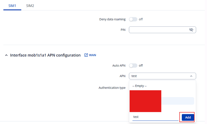

If the SIM card works in another device, you could try entering the APN manually. To do this, navigate to Network → Mobile → General , where you will be able to set the APN as shown in the image below.
Please keep in mind that the APN settings depend on the operator you are using, so you may want to confirm the correct APN details with them.
