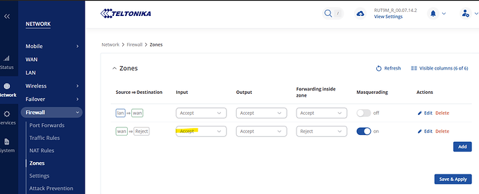

I had to change the setting Firewall->Zones->wan->Input, from Reject to Accept
The WebGUI is now accessible again and the scheduler also seems to work correctly.

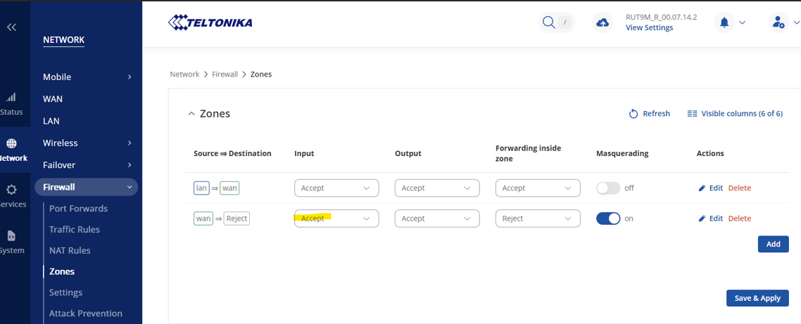

I have changed the default password, but the WebUI is only accessible, with the setting Firewall->Zones->wan->Input Accept
(i think that was not the factory default value)
Or is there something else not optimal in the configuration?
