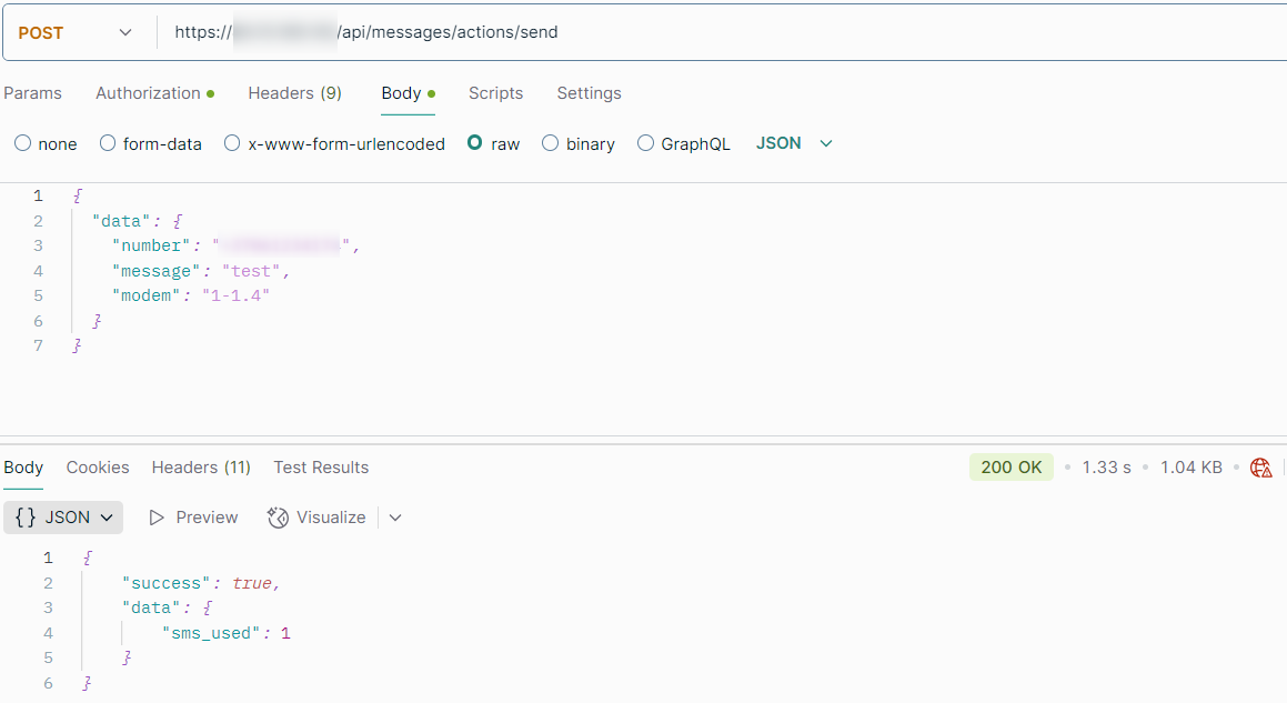

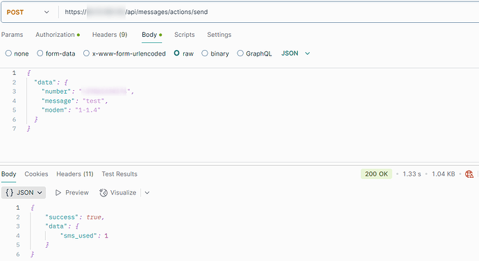

Furthermore, just to confirm, I’ve checked, and SMS sending via the API endpoint also works as expected:
Could you please let me know what response message you receive when attempting the request?
