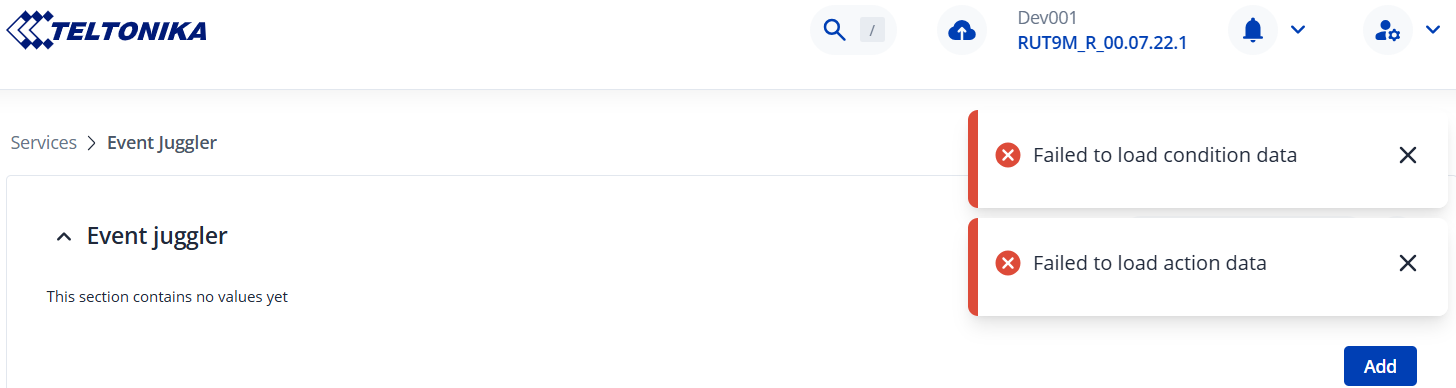

Hi all
I have just updated my RUT956 to **RUT9M_R_00.07.22.1.
After that, I have seen that Event Juggler is missing, showing several errors.
Several errors appear in system log too.
747 Thu Apr 30 11:09:01 2026 daemon.err uhttpd[16778]: Configuration: event_juggler does not exist
748 Thu Apr 30 11:09:01 2026 daemon.err uhttpd[16778]: stack traceback:
749 Thu Apr 30 11:09:01 2026 daemon.err uhttpd[16778]: [C]: in function ‘error’
750 Thu Apr 30 11:09:01 2026 daemon.err uhttpd[16778]: ?: in function ‘_get_config’
751 Thu Apr 30 11:09:01 2026 daemon.err uhttpd[16778]: ?: in function ‘populate_configs’
752 Thu Apr 30 11:09:01 2026 daemon.err uhttpd[16778]: ?: in function ‘Get_TYPE’
753 Thu Apr 30 11:09:01 2026 daemon.err uhttpd[16778]: ?: in function ‘?’
754 Thu Apr 30 11:09:01 2026 daemon.err uhttpd[16778]: ?: in function <?:566>
755 Thu Apr 30 11:09:01 2026 system.err API: /usr/lib/lua/api/services/event_juggler_actions:Configuration: event_juggler does not exist
756 Thu Apr 30 11:09:01 2026 daemon.err uhttpd[16778]: Configuration: event_juggler does not exist
757 Thu Apr 30 11:09:01 2026 daemon.err uhttpd[16778]: stack traceback:
758 Thu Apr 30 11:09:01 2026 daemon.err uhttpd[16778]: [C]: in function ‘error’
759 Thu Apr 30 11:09:01 2026 daemon.err uhttpd[16778]: ?: in function ‘_get_config’
760 Thu Apr 30 11:09:01 2026 daemon.err uhttpd[16778]: ?: in function ‘populate_configs’
761 Thu Apr 30 11:09:01 2026 daemon.err uhttpd[16778]: ?: in function ‘Get_TYPE’
762 Thu Apr 30 11:09:01 2026 daemon.err uhttpd[16778]: ?: in function ‘?’
763 Thu Apr 30 11:09:01 2026 daemon.err uhttpd[16778]: ?: in function <?:566>
764 Thu Apr 30 11:09:02 2026 system.err API: /usr/lib/lua/api/services/event_juggler_conditions:Configuration: event_juggler does not exist
Thank you very much for your interest and help.
Kind Regards
Luis

Hi Justinas
finally I could try your instructions on the router.
First, I reflashed the firmware to the new version RUT9M_R_00.07.22.1 via the bootloader, and then I recovered the backup. But, the router went back to the previous situation with the same problems :-(.
Later, I changed the firmware to the old one, RUT9M_R_00.07.20.3, and recovered the same backup again, as the configuration was lost.
Now the Event Juggler is running as before, maintaning the previously defined events.
So, it looks that it is problem related with the firmware update to RUT9M_R_00.07.22.1
Note: New Data inputs on Data to server cannot select the Wifi scanner type, although previously defined ones continue working with that data type.
Probably this is an error not related to the above one.
Thank you for your interest
Best Regards
Luis
Hi Justina,
I updated the router firmware to RUT9M_R_00.07.21.2, and the router worked perfectly. Those errors did not appear.
But, later I have updated to RUT9M_R_00.07.22.3, and those errors are shown again.
Then I have just update to the last version RUT9M_R_00.07.23.4, but the problems continue there.
Any idea how to solve it, because now I have to return to firmware RUT9M_R_00.07.21.2 and I do not know if I will be able to update it in the future.
