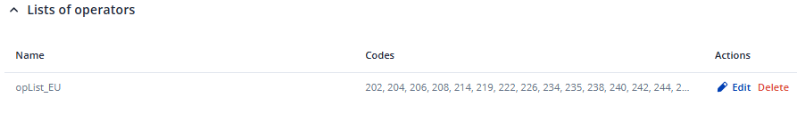

If your objective is to control which networks or countries the device is allowed to roam on, I would recommend using the Operators List feature:
https://wiki.teltonika-networks.com/view/RUT956_Mobile#Operators_list
This allows you to create a list of approved operators that the device is permitted to connect to.
Once the list has been created:

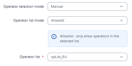

  1. Set Operator Selection Mode to Manual
  2. Set Operator List Mode to Allowlist and the operator list you previously created
Guide: https://wiki.teltonika-networks.com/view/RUT956_Mobile#Manual_operator_selection
With this configuration, the device will only connect to operators included in the approved list, helping to prevent connections to unwanted roaming networks.

Hi Nick,
thank you for the explaination! If I scan for operators, I always run into a time-out problem. But as one can choose to allow entire countries (only MCC), I just chose all countries within my SIM contract. That should have the same result, right?
Oh and “Deny data roaming” OFF then, correct?

Hi Vilius, hi Nick,
thank you for the detailed explanations. So during the last trip I tried the combination that Nick suggested (Operator Mode: Manual and Allowlist with only European operators), but it turned out to not work. It seemed I only had my “home operator”. As soon as the router left Germany, the connection was lost. Is there a another way, like Operator Mode: Auto but still only from the Allowlist? Or like a fallback/“watchdog” cycle for the operators, that I need to activate?
Best regards
Robert
Greetings, @RobertF,
Could you please confirm whether the suggested approach helped resolve the initial issue?
Additionally, since you mentioned that the connection was lost after leaving Germany, could you please check whether the Deny data roaming option is enabled under Network → Mobile?
I look forward to your response.
