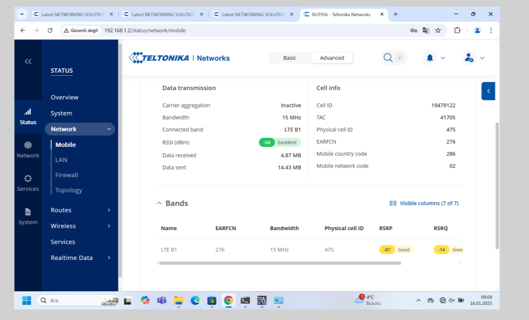

To assist you better, could you please provide a screenshot from the Status → Network → Mobile page of the second router?

In topologies section when I scan device in WAN it shows No Devices found message you can see in the picture
Thank you for providing additional requested information.
To troubleshoot the problem further, I’ve sent you a form to fill out. Please use 11759 as the ticket ID when completing it. Once submitted, we’ll contact you privately to investigate and address the issue more effectively.
