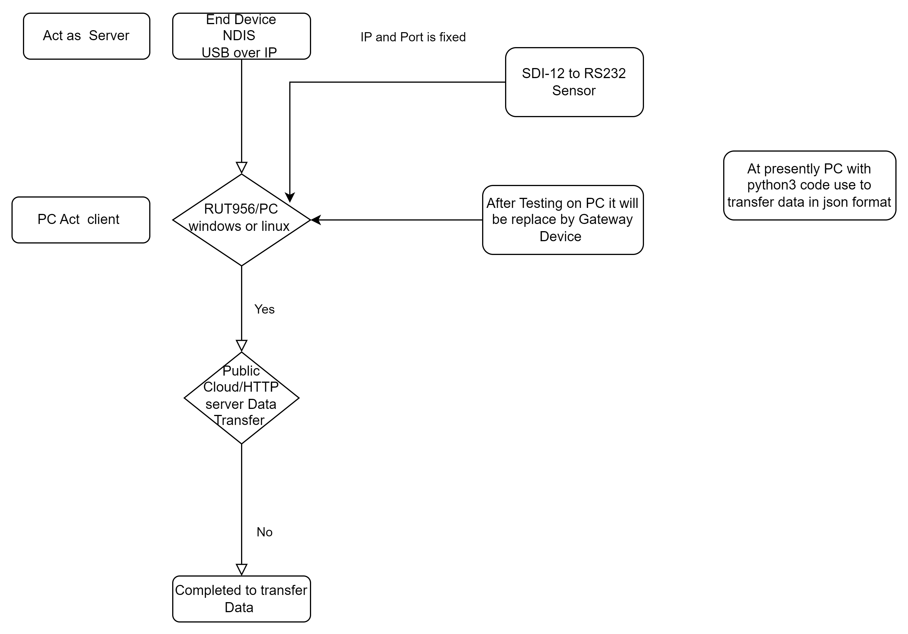

I am trying to connect USB over IP device using RUT956 to connect and send it message in customized format and then received reply forward to http server ,or mqtt server .Please suggest is it possible using RUT956 . As I have done this using RPi and developed application in python .

Regarding the link below, is this the one you’re looking for? you will forward it from USB over IP to a specified server that you support on a specific port, However, when it comes to the message, the server will act as the master.
If possible, provide a topology for your project and how you intend to proceed.

Please find the attached scenario @ presently using python we send message to server and get reply and that reply forward to http server .
By default, our device is not able to send the customized json data from a third-party device using data to a server python3 code because it will be saved in Modbus RAM and it will not be able to send it to a server from a third-party device using python3 code; thus, you need a custom script in that case to instruct our device to send the python3 code customized in json format to your Public Cloud HTTP server.
