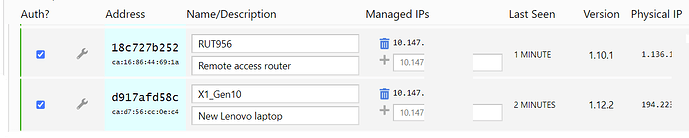

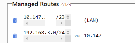

I have a RUT956 which I want to use for testing PLCs in the field. Using the instructions below, I have been able to add it to my ZT network, but I cannot ping it from my PC which is on ZT, nor can I ping my PC from the RUT956 using the web UI and connected through the wifi. Obviously, I also cannot access my PLCs. Is there something obvious I’m missing here that is not in the instructions? Any help greatly appreciated. Thanks.

Thank you very much Janmiguel! Your response to that post appears to have resolved my issue.
