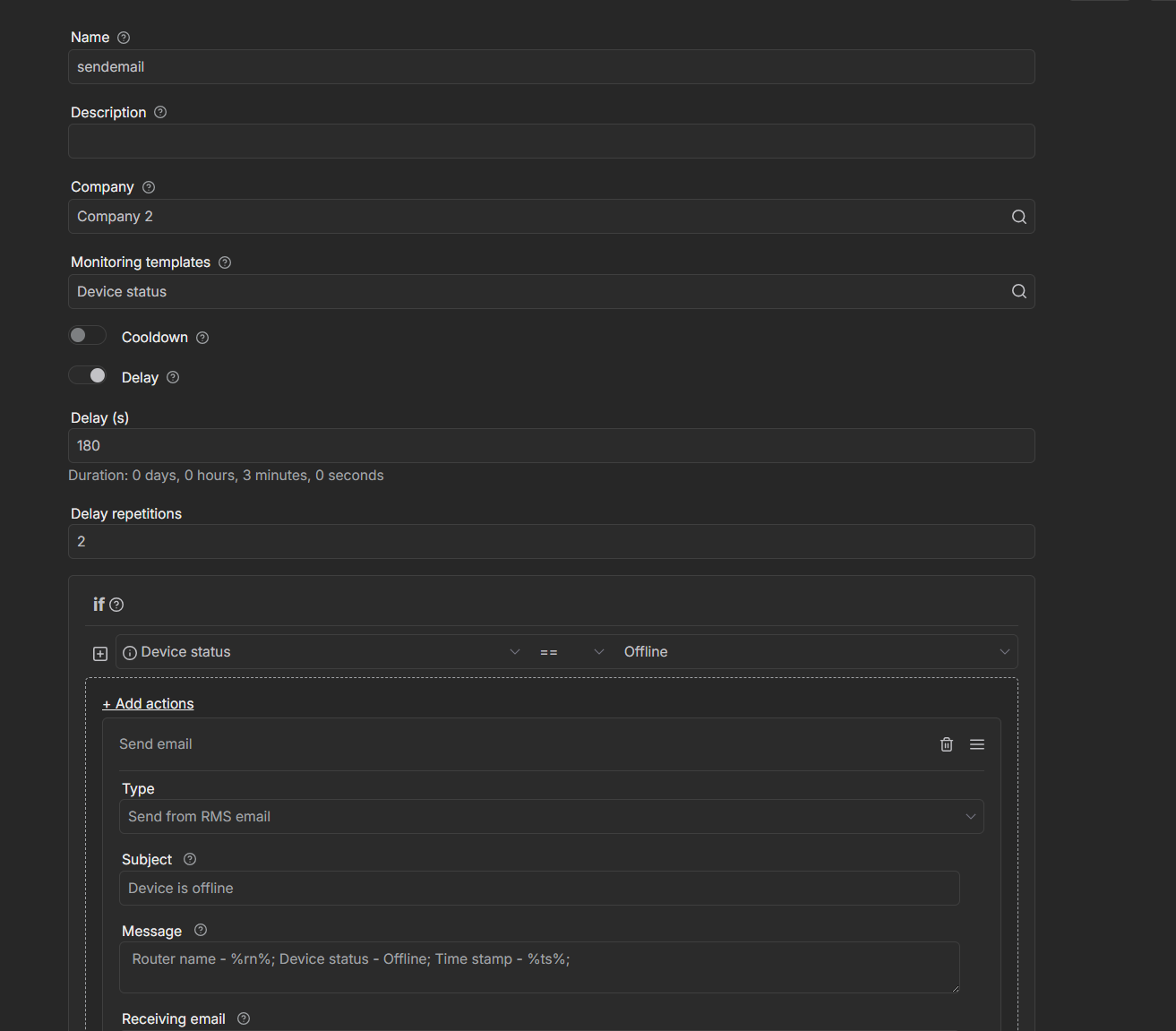

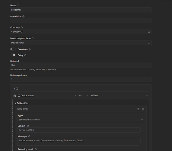

You can configure a delay for the alert by setting it to 180 seconds. This way, the system will only send an email if the status remains offline for more than 3 minutes.
It should look similar to this:
