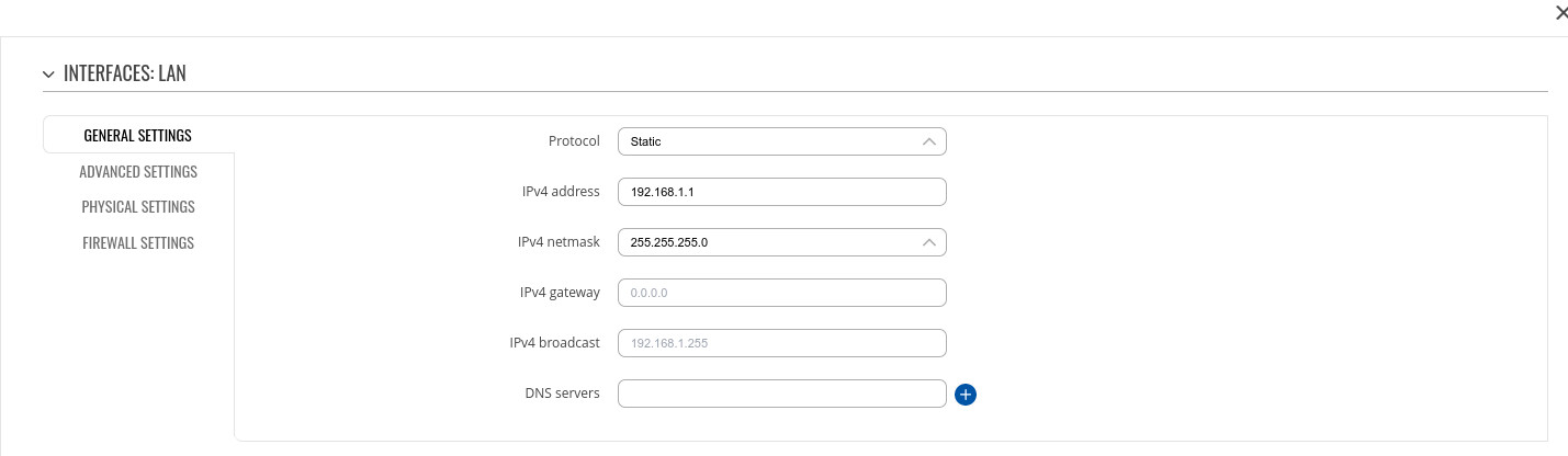

I add here below a screenshot of the LAN settings on RUT955.
Physical Settings → Bridge interfaces (enabled) → interface eth0.1
Firewall Settings → Create/Assign firewall zone: lan
DHCP Server is enabled, start ip 192.168.1.100 to 192.168.1.249
Dynamic DHCP is enabled
IPV6 settings, all disabled.
Alberto
