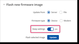

Before proceeding with that, I’d suggest checking whether the issue persists after upgrading the firmware to the latest version RUT9_R_00.07.06.17 if feasible without the “Keep Settings” option being selected; if it is a hardware issue, the rebooting behavior will remain unchanged.
Let me know how it goes.
Because we have only remote access, what does “Without the “Keep Settings” mean to us? That we have to go onsite ? We are quite far away …

While updating the firmware version, you have option on WEB UI
If you have remote access to the device WebUI, you can disable the “Keep Settings” option when upgrading the firmware via System → Firmware. Please note that without “Keep Settings” selected, all current configurations will be deleted, meaning the device will be factory reset after the update.
