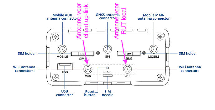

Hi, for the RUT955, which has 2 WiFi antenna connectors, we connected only the top (client up-link) and cannot find any AP. Don’t find it in any hardware documentation which antenna is for STA and which for AP?
Can it be that we also need to connect the lower WiFi antenna for AP?

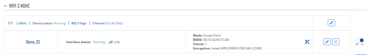

Even without inserting the Wi-Fi Antennas, you should be able to detect RUt955 2G Wi-Fi. The image below shows that 1 Wi-Fi Client is connected.
For good practice, we suggest our users to insert both Wi-Fi Antennas for better coverage and signal.

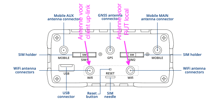

So my assumption is that the lower WiFi connector is for the uplink?
We’ll connect both antennas for now to check if that creates better search and find other networks.
