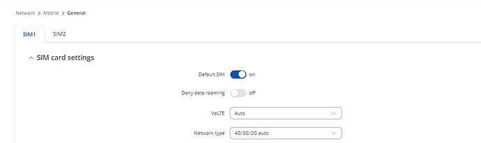

You should be fine. There is a setting in the router under Network/Mobile to deny data roaming which is off by default, meaning that the SIM will roam unless you specifically set it to not roam. I haven’t used a SMARTY SIM abroad but I see no reason why it wouldn’t work.

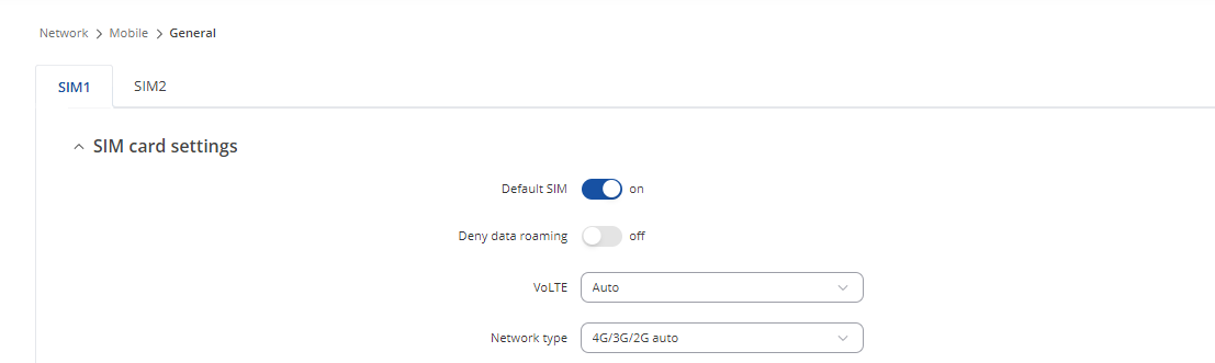

And from the WebUI, on the Network > Mobile > General there is a section for deny data roaming. Just please be sure this is disabled. I also attached the screenshot below.
