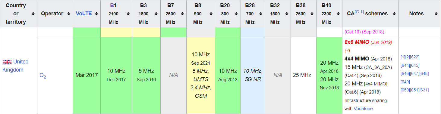

According to Wikipedia, O2 UK uses these bands for LTE:
So you could try whitelisting only these bands to check if the connection improves:
  • B1
  • B3
  • B20
  • B40
Let me know how it goes.
