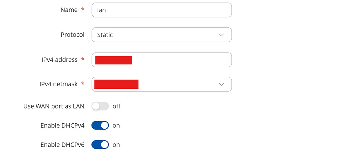

I need to update this config from static to DHCP but am only seeing the choices of None or Static. Can someone walk me through updating our LAN IP to DHCP?
Good afternoon,
In majority of our devices that have a 7.15.4 Firmware version, DHCP functionality would be exactly as you provided in the screenshot, just a little bit below.
In older firmware, None actually means the interface will obtain IP automatically via DHCP or effectively disables static IP assignment on that interface. This corresponds to enabling DHCP on the LAN interface.

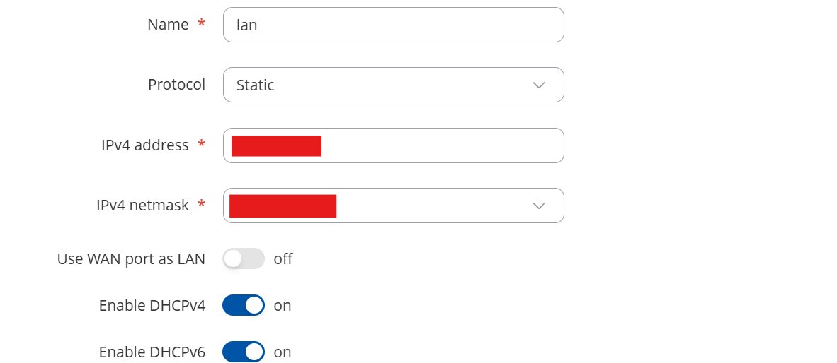

This Rut955 is running 7.06.18 and is listed as the latest/stable version. Previously, DHCP option has always been in the “drop down” menu.
