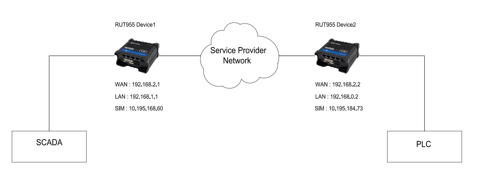

I’m trying to make a static IP routing vis static IP SIM cards network between 2 RUT955 with firmware version (RUT9_R_00.07.04.2) as per attached architecture.
I already tested the same architecture with wired WAN network and it is working with me successfully.
My simple architecture is as below:

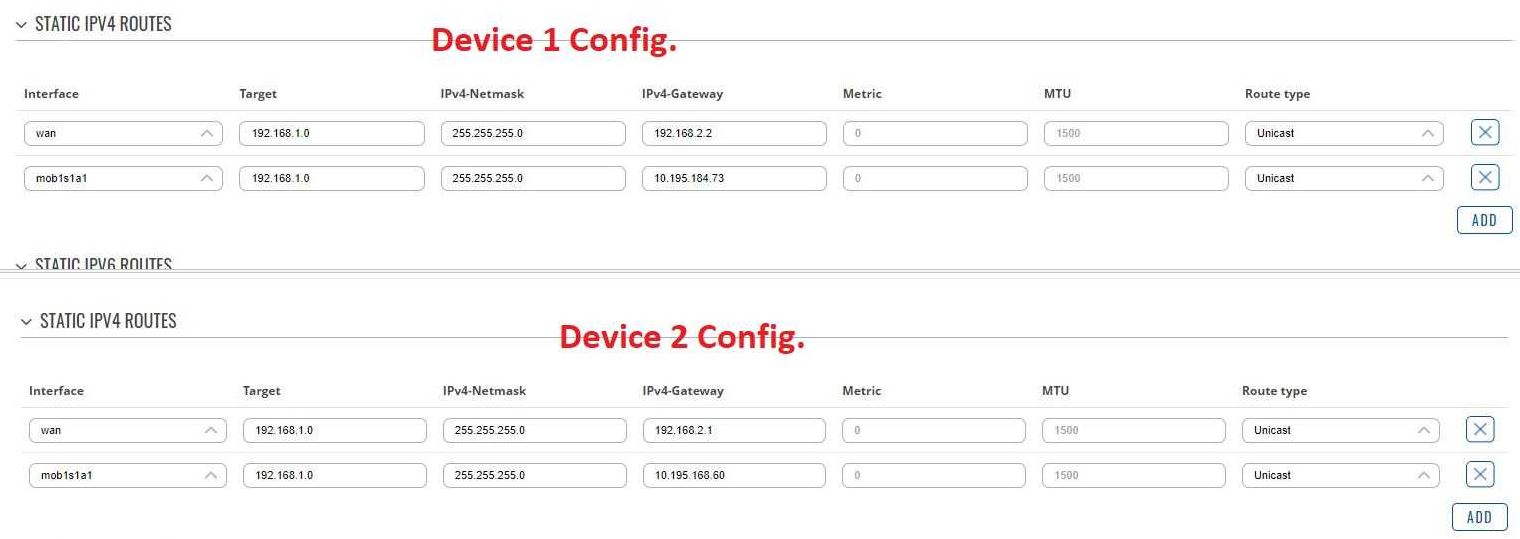

The Static IP routing configuration for both devices:

Kindly note that the actual architecture is as below and I’m working with 2 different LAN networks (1st architecture there was amistake in the IPs)
Currently I can ping the SIM IPs from the second side as below
Ping
But the problem now that I can’t reach the LAN devices from the second side, I’m sure that the problem not with the ISP as we did same task by another brand at same network.

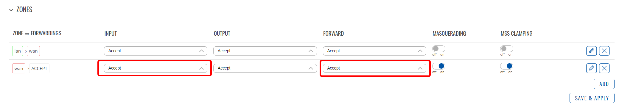

Make sure that Input and Forward chains are set to Accept:

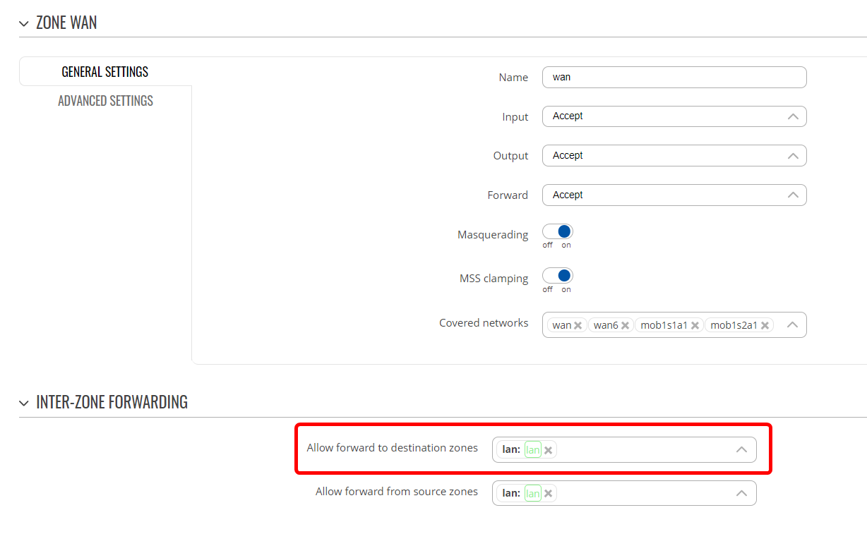

The edit the WAN zone, and make sure that LAN is added to Allow forward to destination zones field:
These settings should make the LAN zone accessible from the other networks.
