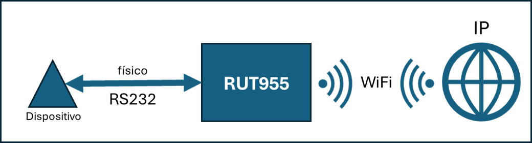

I have a device that sends strings over the RS232 port. I need to store these strings and send them to an IP address over a WiFi network. I thought about using the “Data to Server” service.
I need step-by-step help configuring the RUT955.

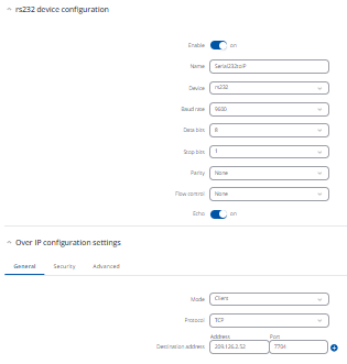

I have configured the “Serial Over IP” as the RUT connects to the server’s IP address and sends data.
However, the data does not arrive at the IP address.
See my configuration in RUT.
Does the fact that the RUT encapsulates the data change its format?

I need to do this.
The data to server feature depends on other services to collect data, such as Modbus, DNP3, Wifi Scanner, etc. In your case, since the device does not support those protocols, you cannot really use Data to Server functionality for this.
As for Serial Over IP, it does not modify the payload, just encapsulates the data so it can be delivered over TCP/IP.
Firstly, I would suggest to first test this feature locally to ensure that it is configured properly. Install some TCP/IP server (for example, Hercules here). Start the server on your PC and try sending data to your PC via Serial Over IP feature. Please, make sure that the firewall on your PC does not block traffic. Once you start getting data on your PC, you can be sure that Serial Over IP is configured properly and works. Then, you can try sending RS232 data to your remote IP address.
