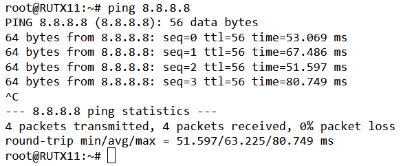

  1. Execute this command: ping 8.8.8.8 and screenshot the result. If it has a connection, the output should look similar to this.
2024-02-28-09-00-21-RUTX11 - Teltonika Networks — Mozilla Firefox

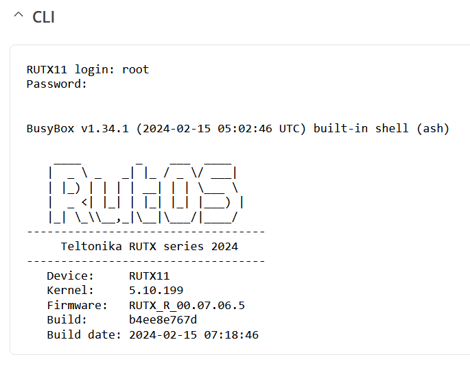

Tried CLI, and got no response
Teltonika RUT955 - CLI

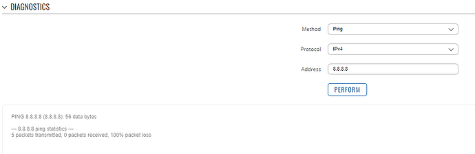

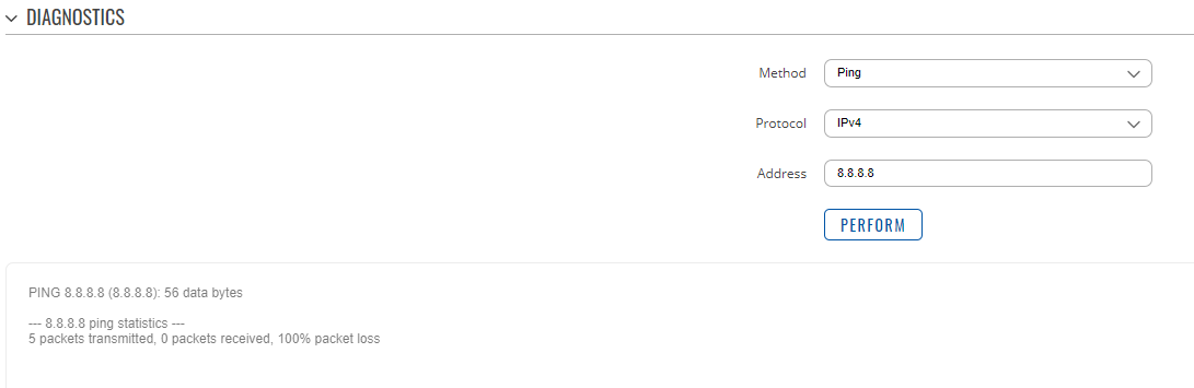

Also tried Diagnostics and got no response
This would take me down the path that although everything says connected to internet that in fact it is not, which then would appear to be the source of the problem.
Identifying that problem still seems just out of reach though
