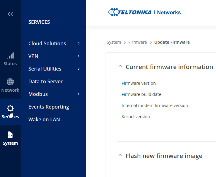

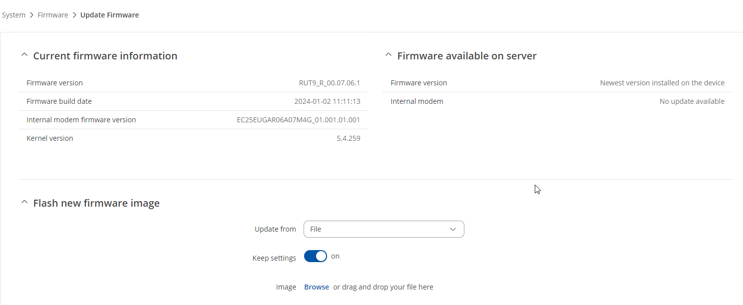

  • To make sure, Please try doing a firmware upgrade to the “7.06.1”, you can find the firmware file on link below
    RUT955 Firmware Downloads - Teltonika Networks Wiki
    You can upgrade the firmware on the router following below:
    WebUI > System > Firmware > Update firmware > Upload the firmware
    Note: Doing the firmware upgrade without “Keep settings” option ON will wipe out all existing configurations, and device might lose remote connectivity. Therefore, It will be up to you whether to keep the setting or not, as it is an optional decision from your end. and it is advisable to perform the firmware upgrade when the device is physically accessible to you or if you can ensure remote access through RMS or SMS Utilities as backup access.

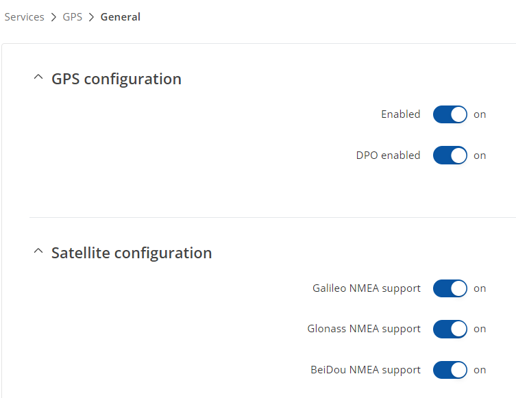

  • Another thing, make sure you have turned on ALL Satellite Configuration in Services > GPS > General. as per the screenshot below:

Hello. Thanks for reply. I was on FW “7.06.1” and today i installed it again through file from link in post.

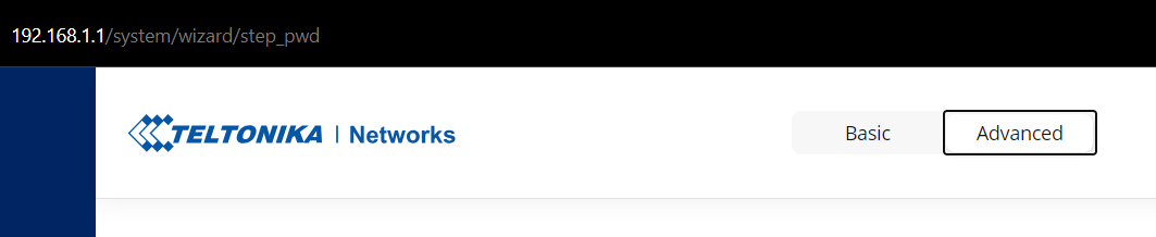

Interesting thing is that in other device that is in the field i have a situation that i can not find GPS section in web GUI so i can not check GPS settings, but i am getting GPS data from router so it looks like it is working.
Can you tell me how can i get beck GPS section in WEB GUI.

Kindly make sure that you are in Advanced mode.
