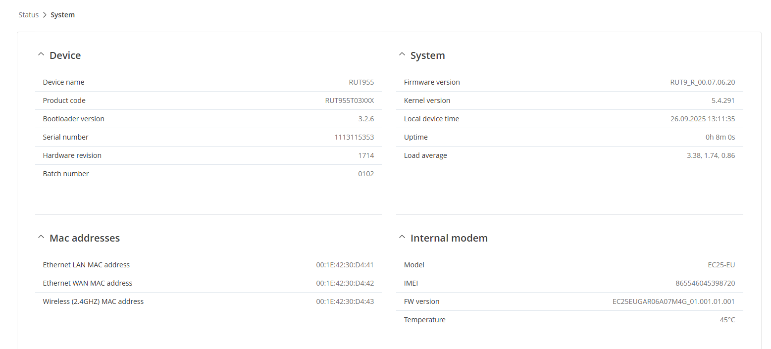

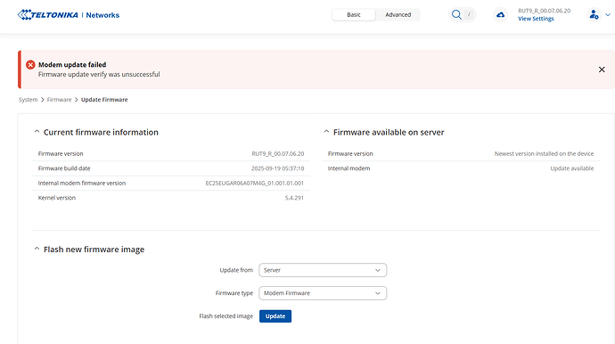

Hello, I have upgraded the firmware to RUT9_R_00.07.06.20. But web ui asks for modem update. During the update it fails. I have tried via wifi, lan, and over mobile connection but it failed. Web ui is always asking for the modem update and it fails.
Below, I have attached screenshot and my device details.

I have solved the issue by fallowing the commands in the topic: TRB500 modem firmware update from RG501QEUAAR12A05M4G - #4 by bot
