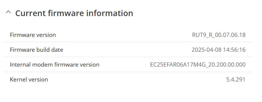

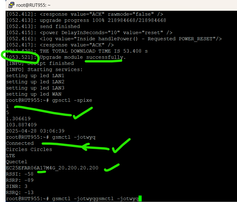

The firmware update from server doesn’t suggest a new modem firmware, so I updated them manually to EC25EFAR06A16M4G_20.200.20.200 (using modem_updater.sh) and hey presto - GPS functionality returned.
I found firmware EC25EFAR06A17M4G_20.200.20.200 online and flashed 2 modems with this to test, and they seem fine; GPS ok, data connection ok.
Is firmware EC25EFAR06A17M4G supported for the EC25-E modems? or shall I roll back to EC25EFAR06A16M4G.

The issue was identified as the internal modem being in Emergency Download Mode.
A remote session was arranged to recover the modem, and the latest internal modem firmware was successfully updated.
