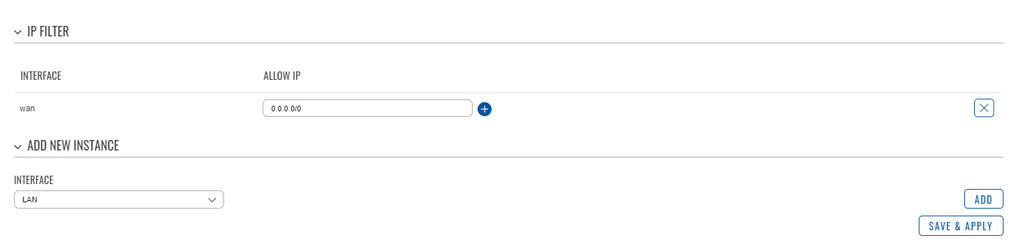

While I am not fully aware of the settings you have, could you please first try to disable Modbus server on RUT955 and put 0.0.0.0/0 into IP filter on the Modbus TCP over Serial configuration page (if you are trying to access via WAN, make sure you select WAN interface).

Yes, I did disable the Modbus Server and used 0.0.0.0/0 as an IP filter.
I am also only using the LAN interface. (But you will see this in the troubleshoot file.)
