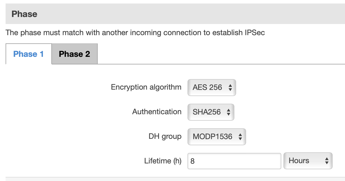

I am trying following options in RUT, but it just does not connect anymore:

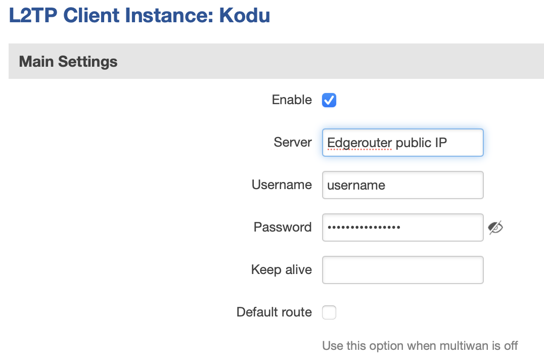

I had a limitation of 1 screenshot per post, therefore sorry for several posts on this topic.
However, now all my VPN configuration should be well visible.
Please help, what is wrong there.
Thnaks in advance.
