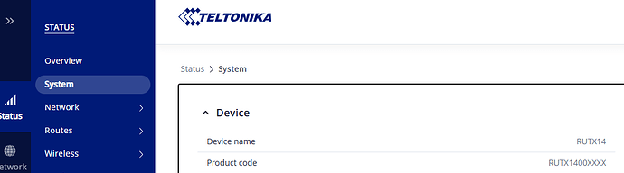

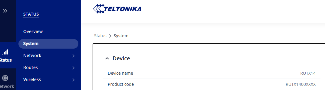

Could you please navigate to Status → System and check the product code of your device?
Because firmware version RUT9_R_00.07.00 and later are not supported on legacy-design (RUT955X7VXXX ) devices.
If the product code is not RUT955X7VXXX, please try updating the firmware via the bootloader menu. Keep in mind that this process will restore the device to its factory default settings.
