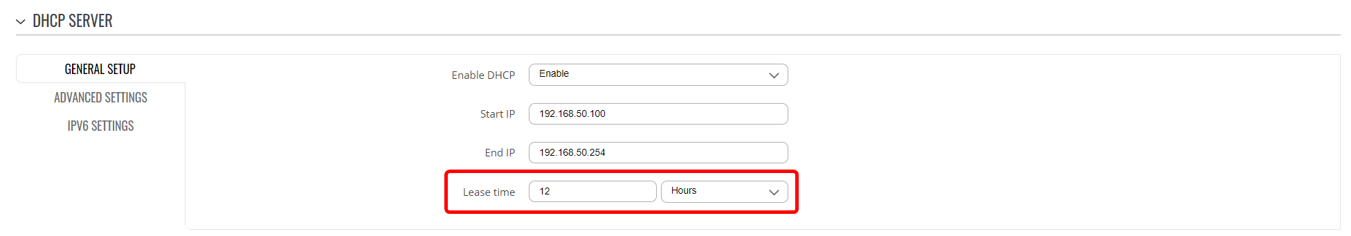

It is also possible to shorten the lease time by navigating to Network → LAN → edit the LAN interface and under the DHCP server option shortening the lease time:
