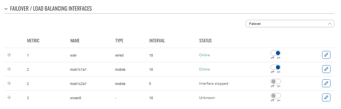

We have Stations which primarly have DSL and a backup SIM in Slot 1.
So my failover config would be this:
WAN Primary and mob1s1a1 for SIM1 secondary?
I’m getting confused as WWAN0 also gets referenced as Interface for Mobile Connections and a show route on the cli only shows WWAN0 and not mob1s1a1.
So is it safe to disable WWAN0 in failover when mob1s1a1 is enabled?
Both, Mob1s1a1 (SIM1) and Mob1s2a1 (SIM2) interfaces are logical interfaces for the wwan0 interface. In the WebUI, there should be no wwan0 and you should only see the logical mob1s1a1 and mob1s2a1 interfaces. Could you please clarify why the wwan0 interface is in the failover menu?

When mob1s1a1 is used, the route in CLI will show wwan0.
Could you please clarify if failover is working properly? If everything is working properly, you can leave it.
Maybe you added the wwan0 interface yourself in Network → WAN? If so, did you configure anything on it?
