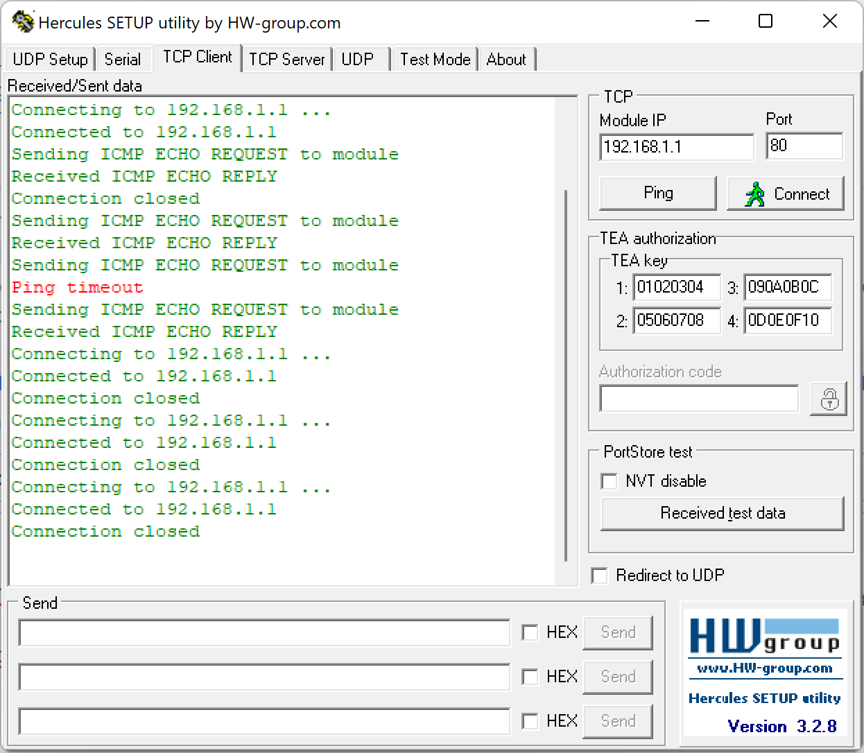

I am using the Hercules utility to test my connection with the RUT955 device. I want to sent back any gps data, in json format. But, instead, nothing on the Hercules TCP Client tab. And after few seconds, it prompts “Connection closed“. I run it on my local network to test it out.
Is there any extra configuration i should do to my RUT955 device?

During the session, we successfully verified that GPS data can be transmitted to a local PC connected to the device via an Ethernet cable. In the next step, the requirement is to forward the GPS coordinates to a remote server, which requires a stable internet connection on the router side.
At the time of the remote session, internet access was only available via a Wi-Fi network located in another building. Due to the weak signal strength, the connection was not stable enough to proceed with further testing. The client will test the setup again once a reliable internet connection is available and will provide an update accordingly.
