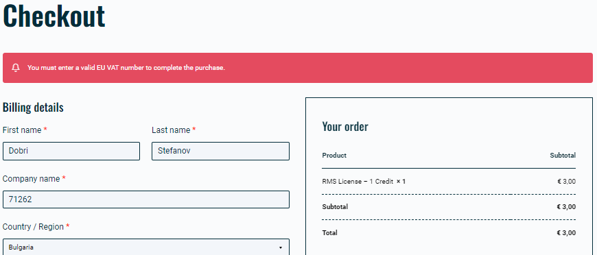

At some point about an year ago I have access to my device via https://rms.teltonika-networks.com/ web and after that I have no access to the device with default user/pass admin/admin01. I tried to buy RMS license wihtout success with the hope that I will be able to access the router again via RMS web portal. Even thought VAT number is not mandatory based on the info from the web form I am not able to finish the payment.
