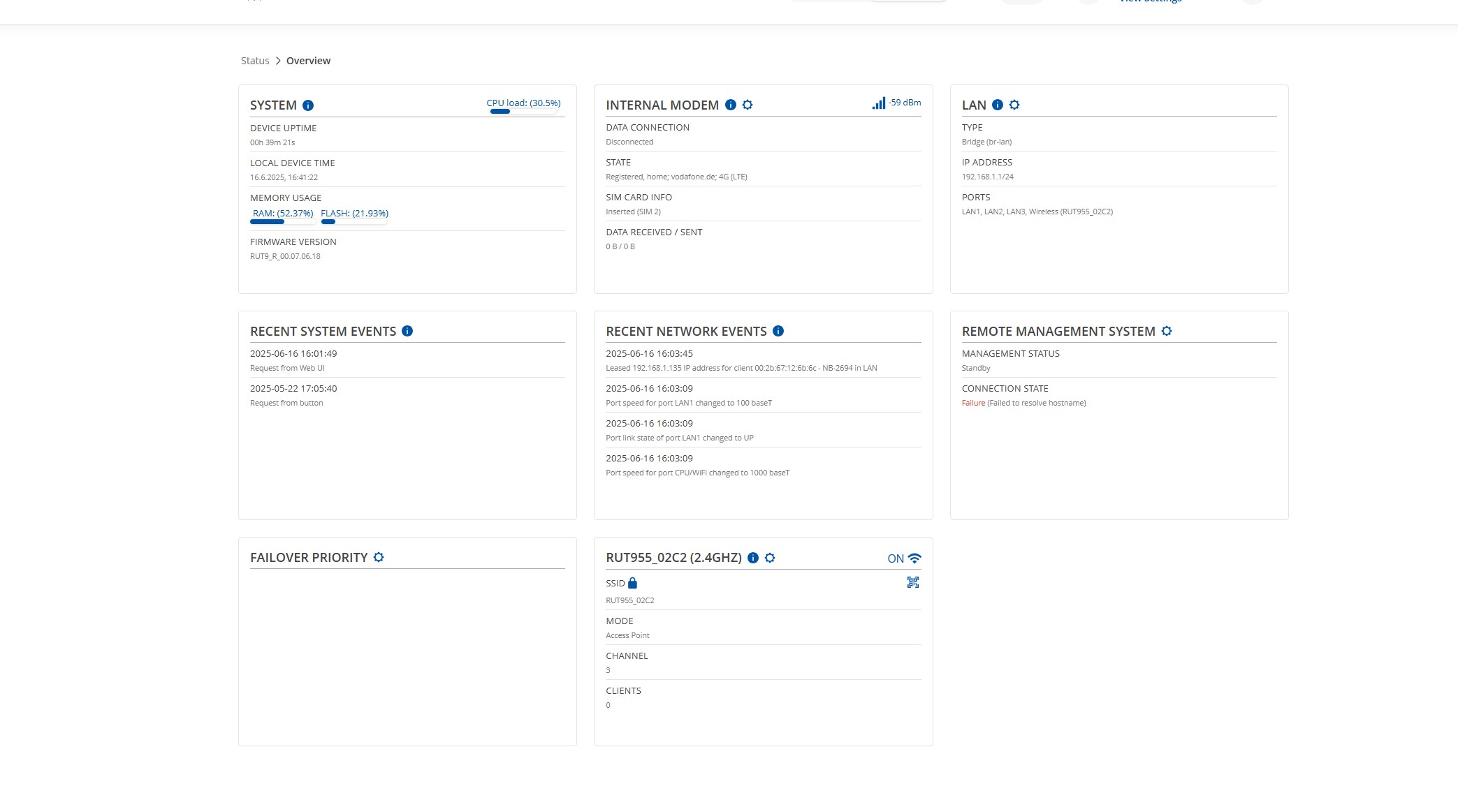

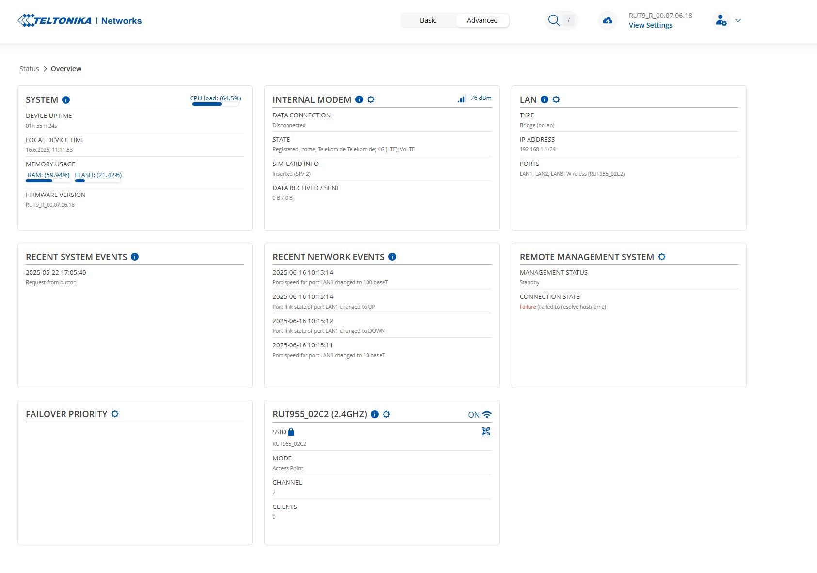

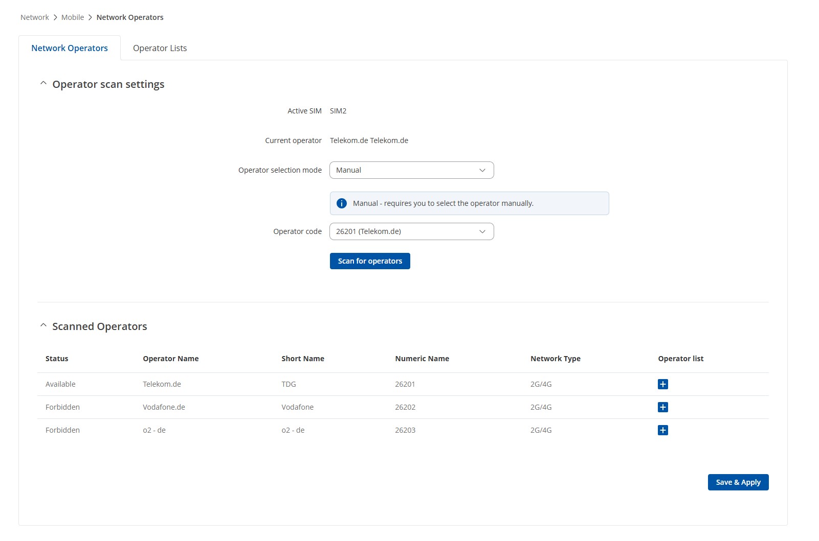

I’ve attached a screenshot from the overview which might help to indicate the issue.
Understood,
Well it seems that the SIM is inserted and registers - so kudos to that, modem is working :smiley:

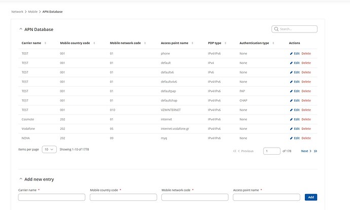

So what other step should be is check the APN - try changing the APN from auto to manual and there should be retrieved a list of APN’s for your operator, try to go through them and see if it works.

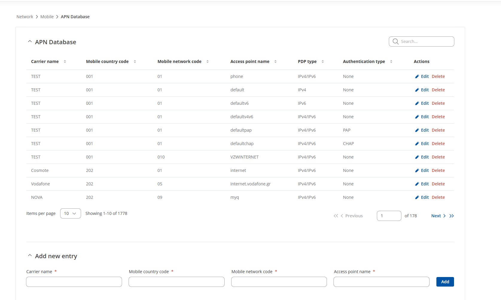

I am with Telekom so far - the other two operators in Germany are not able to take within this Sim. (Screenshot 1)
or do I have to choose one of the APN within the package I’ve got from this page? RUT955 Package Downloads - Teltonika Networks Wiki
There are now 1,778 options to choose and I am lost here

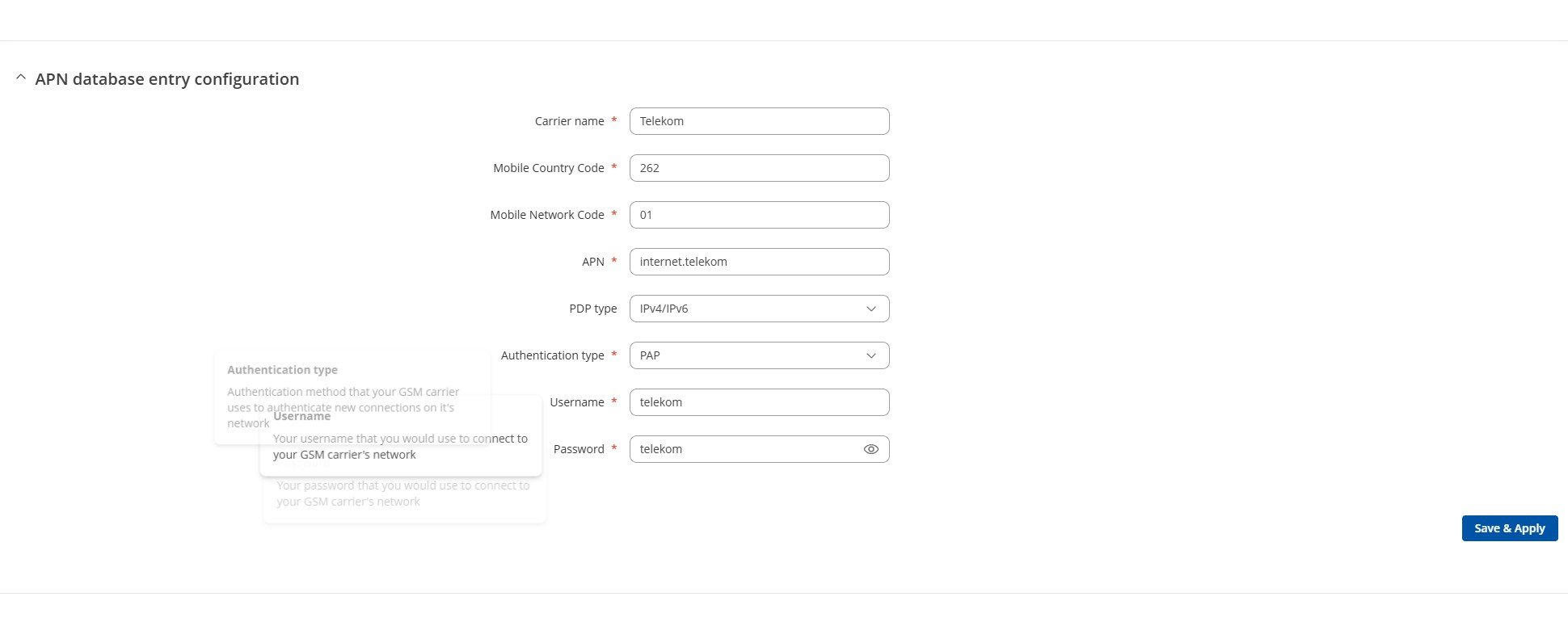

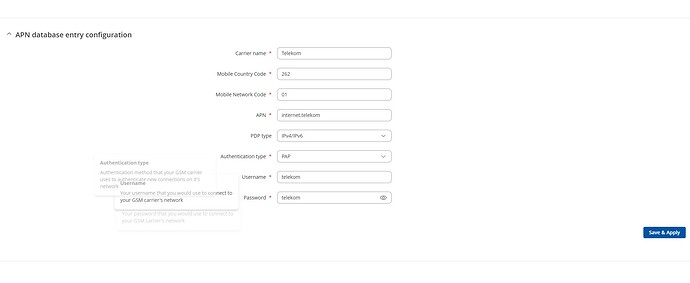

I’ve found the APN matching the number from the scan - so I’ve tried this one.
Another information from the operator found my research is this one:
APN Mobilfunk | Telekom Hilfe
(sorry - it’s german) - I used the first part “aktuelle APN” and changed the password accordingly to the page, but still no success with the connection.
